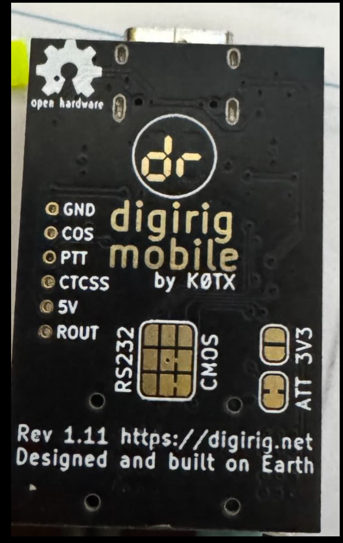

It’s a Digirig Mobile. I got it from Amazon yesterday.
Looks like this inside.
For PTT methods Digirig Mobile supports PTT by RTS signal of the serial port and PTT via CAT command. Have you seen any of these options in iFTx’s configuration?
