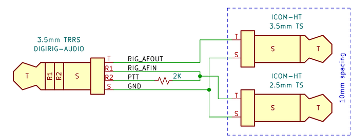

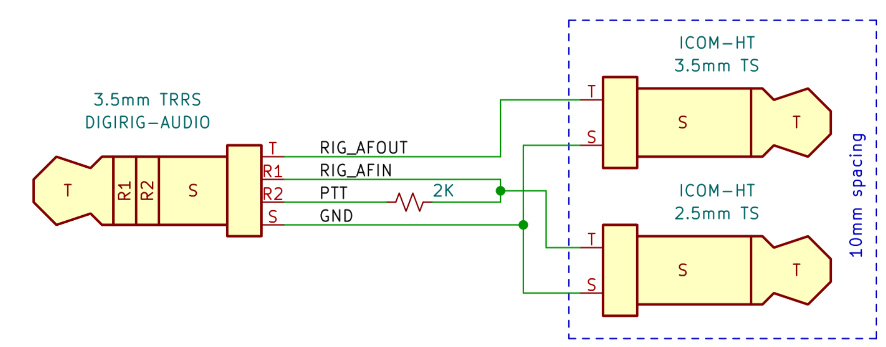

The suggested K1 cable seems to trigger instantaneous transmit with this radio upon power up. Same cable with the Baeofeng works. Anybody else experience this or know of a work around?
