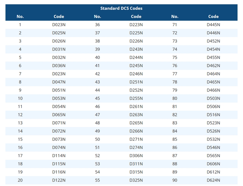

Looks like DCS codes. Just pick the same on both ends of the link. Some info on the subject:
Ok i have some tones that im trying to input thats dpl if that makes any sense
