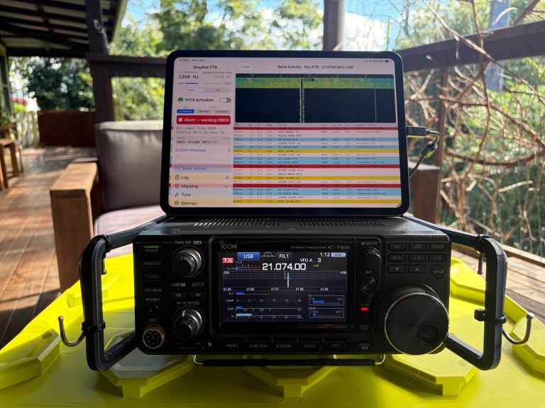

Hello,
I’ve finally got FT8 working well on my iPad thanks to a new app and a Digirig Lite. I’ve written it up in the following post.
Andrew Vk2awn.net
