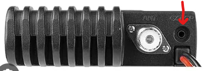

With AT-778 you are picking up the received audio from radio’s external speaker jack. Make sure the 3.5mm TRS jack of Digirig cable is plugged and radio sends audio there. From the settings it sounds like main or main&handmic should work for that.
I don’t have this transceiver but it’s customary for the radio to cut off the internal speaker’s audio when you connect the external. As you change the volume of the speaker that will also affect the audio level received by Digirig. Additional factors are the sensitivity of the input set in OS and AGC.
