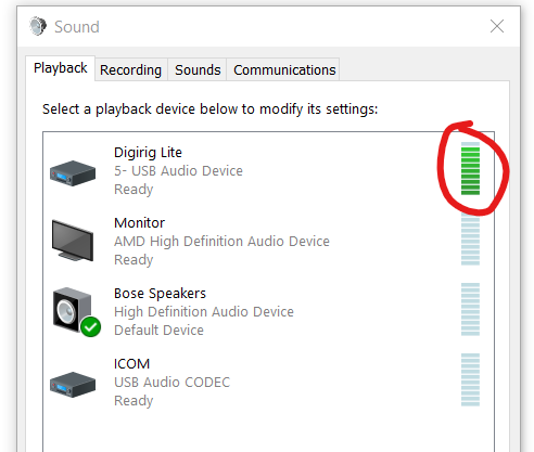

Do you see green bars next to the Digirig’s playback device when attempting to transmit?
Yes, Playback green bars from soundmodem. See Attached.
This should have triggered PTT including activation of red LED if audio sent to both audio channels. Please PM/email for the RMA arrangements, I’ll retest your Digirig inhouse and replace it if needed.
