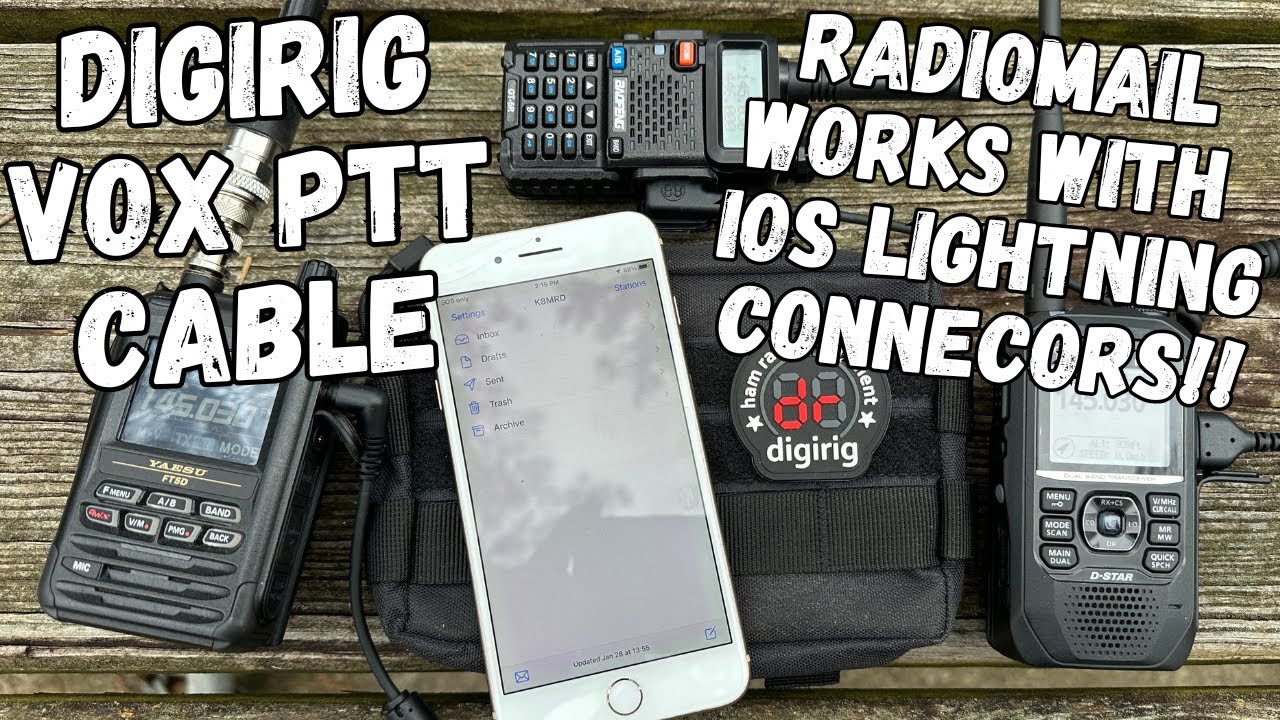

Digirig Lite works with iOS, at this time you’ll just have fewer apps to choose from. Part of the mission for Digirig Lite was to stimulate the development of iOS apps for ham radio and I already see some signs of that.
The settings for the HT are pretty pretty much the same across different models (audio settings, squelch settings etc). You can one of the existing tutorials for the guidance. Here’s Mike’s video from the list of the results that came up when I searched for “radiomail digirig”
It demonstrates the setup with VOX cable, but it will be similar with Digirig Lite.
