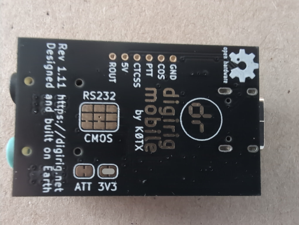

Board v1.11 modification for TX500
I have acquired a digirig mobile v1.11.
I found the video for the mod on PCB v1.9.
I see some things have been moved but all the pads seem the same.
No previous work has been done on the board.
Will just shorting the 3V3 be enough as I have illustrated on attached photo for the TX500 on the V1.11?
Many thanks
73 Darius M0KCB
Yes, shorting 3V3 pad is the only mod you’ll need for TX500.
