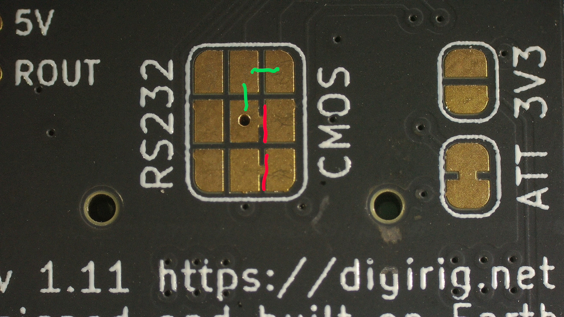

Board v1.11 modification to CI-V
I have a digirig mobile version 1.11. I believe I need to modify it for CI-V for an icom 706mkii. I found the video for the mod on PCB v 1.9. Will the same mod work on PCB board 1.11?
Yes, that’s the correct plan for CI-V mod.
