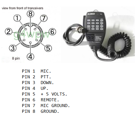

From the pictures of the transceiver it doesn’t look like Alinco DR-B185HT offers any accessory connections. This means that the interfacing will have to be done via the mic port.
Compatible mic is ALINCO EMS-57 with following pinout:
This matches existing store cable (use version with the headphones tail):
