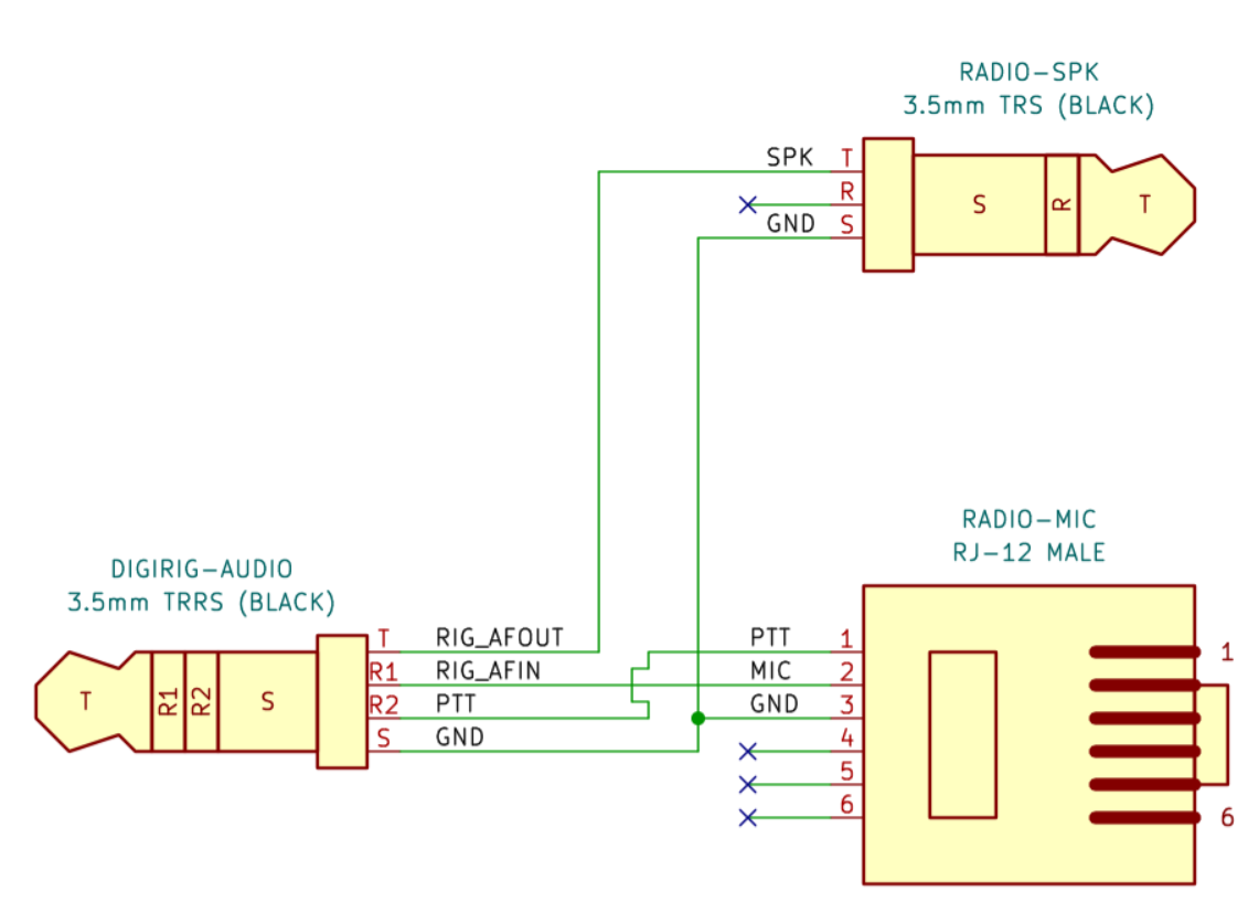

Just to rule out any wiring issues, you can test the continuity of the connection.
RJ-12 cable:
With addition of the adapter the R1 and R2 are crossed over.
Thank you! It seems that the crossover cable is the issue. Pin 2 on RJ-12 has no continuity with any TRRS of the Digirig 3.5
Erik
