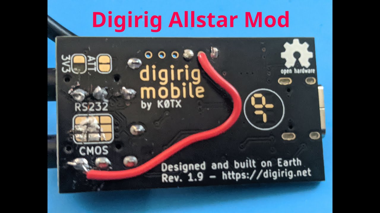

With the USB connected to a RPi3 running hamvoip ASL I can see in the simple USB tune menu that COS is working after soldering a connector to the COS and gnd tap point holes and connecting to the FT-2980R. RX is also working. When I use Droidstar to key, I see PTT also working but no TX pr TX audio on the radio. I attempted to bridge the pins shown here in your post and nothing has changed, tho my soldering work is bad, like really bad. I lifted one of the (3V3) pads and had to solder to the trace for the R2 jumper. I am using a Weller WLC100 with a screwdriver tip. If I had to describe my skill level it would be “generalist” so I can get myself into trouble fairly easily. I am hoping someone has a suggestion on where I could start to get PTT working and the transmit audio working using the digirig mobile. Please keep in mind my knowledge and skill are limited. I am a very visual learner so diagrams and images are usually extremely helpful. Thanks for any help. 73
Hi All, I just wanted to follow up here and mention I did get this working with an ASL private node I am using as a remote based to key a FT-2980R in a metal shop building. The solution which worked for me was bridging the PTT tap hole to the PTT conductor on the 1/8" Audio jack. I also made a video showing what I did here https://www.youtube.com/watch?v=RYtGDxKNouc

w5bsd, I watched your video, and I see where you made your connections for COS and Ground. Where are you connecting your COS/Ground cable to on the radio? I follow the rest of what you are doing, but if you are using the RJ-12 cable, then you have it connected to the radio mic jack and ext speaker jack. Where does your COS and Ground cable connect?
Nevermind! I found it in your previous video! Thanks!
