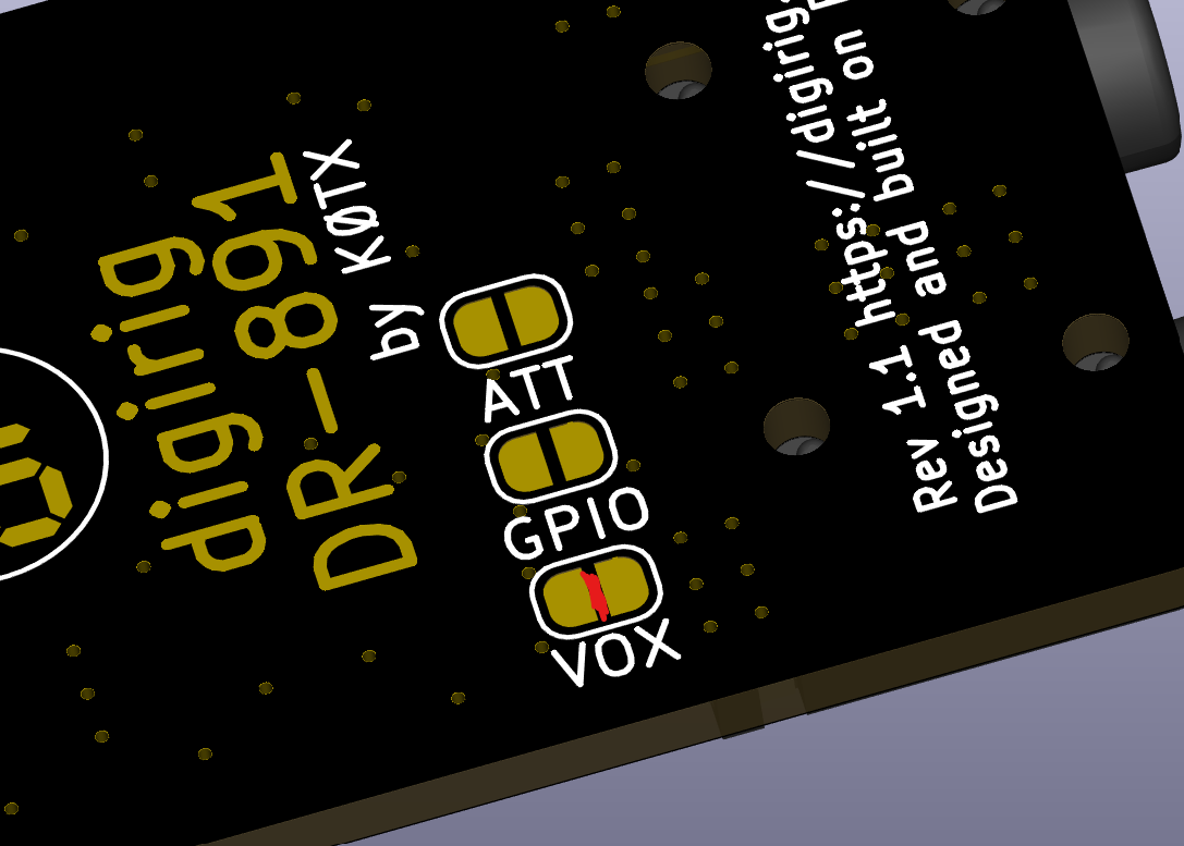

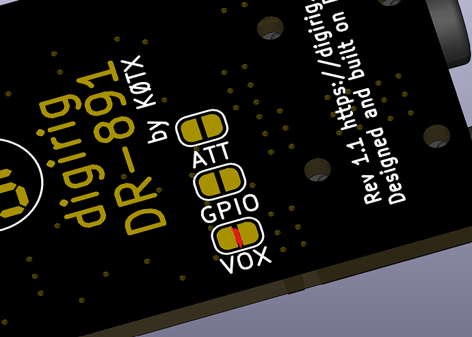

You can disable VOX PTT for good by using solder pads on the back on the PCB - just carefully cut the trace connecting the two pads.
Excellent! That’s what I was guessing when I actually read the manual, just wanted to be 100% sure.
I guess the older mobile version didn’t have this extra little feature?
Digirig Mobile doesn’t support PTT by VOX. The available PTT methods with Digirig Mobile are PTT by RTS and PTT via CAT.
