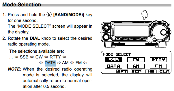

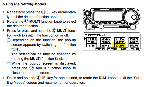

Set mode to digital and make sure to open full bandwidth using WTH menu.
So I made sure those settings were correct, but that did not change the behavior in my original post. On USB good reception, but no transmission. On Data/packet bad reception, but normal transmission.
There must be something I am missing, but I am at a loss.
More update: Now figured out that besides setting width, it also has to be turned on (black WDH). The transmit level setting in sound is now at 90%, the WSJT power slider also, the 891 Data power setting is at 40W and the power meter indicates about 20-25W. Tuner FC50 is engaged. PSKReporter indicates my signals is received properly around the US on 20M.
