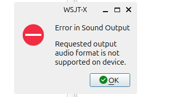

When setting up the digirig I have rig control working but not audio. When setting up the Audio the input list the device but not the output when setting up WSJTX and JS*Call. (I am running Linux Ubuntu 24.4) I can communicate and program the radio (Yaesu FT 817nd(US)) FLRig works as well. the audio settings for computer show the correct device in the output but not the input. Anyone have any Ideas on how to fix the problems

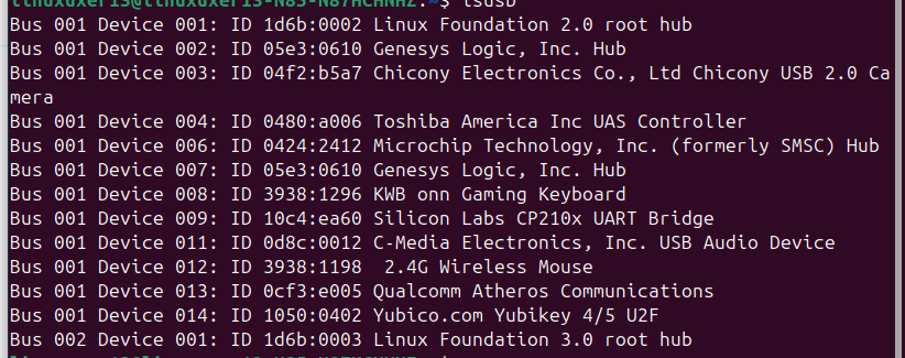

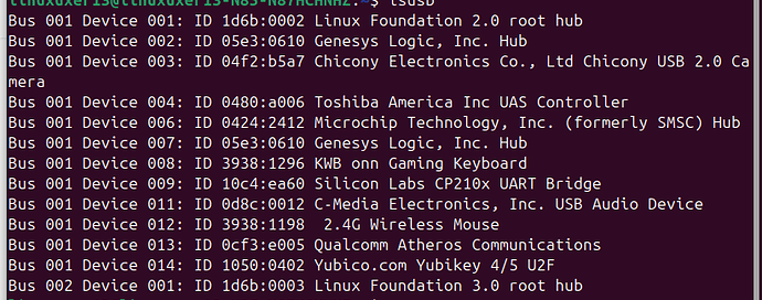

Bus 001 Device 011: ID 0d8c:0012 C-Media Electronics, Inc. USB Audio Device .. Bus 001 Device 009: ID 10c4:ea60 Silicon Labs CP210x UART Bridge
I only get the USB Audio devise in the output but not input
There is just one USB device for the sound card.

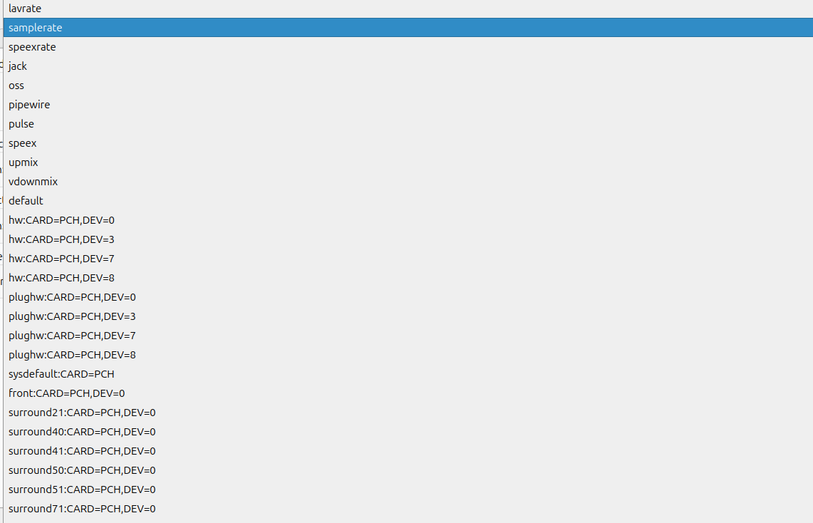

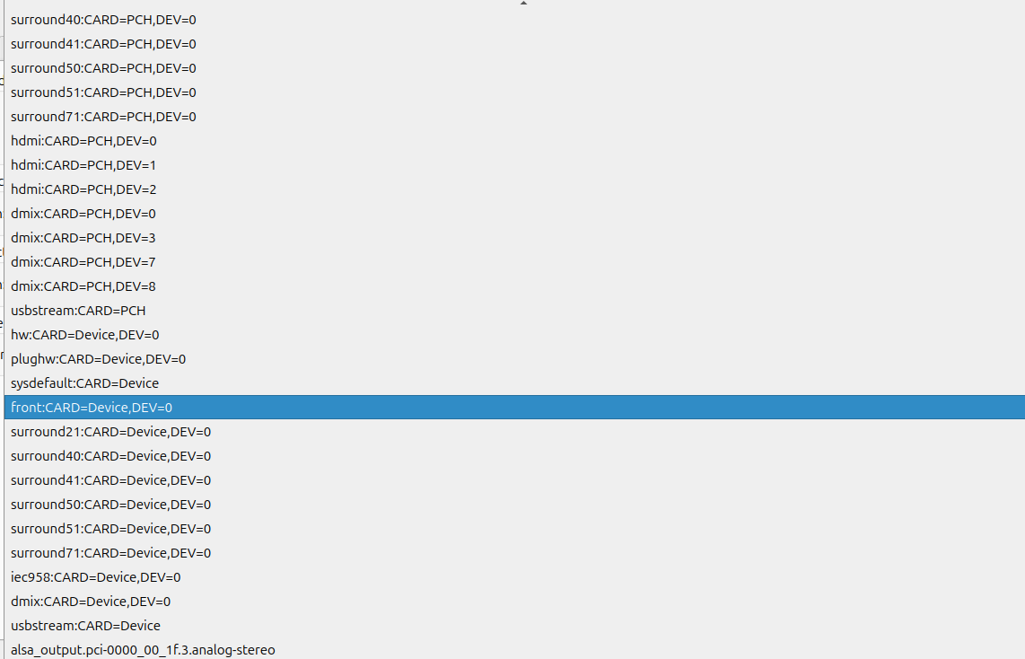

What do the options for the audio devices look like in the dropdown?
first one is input the other is output

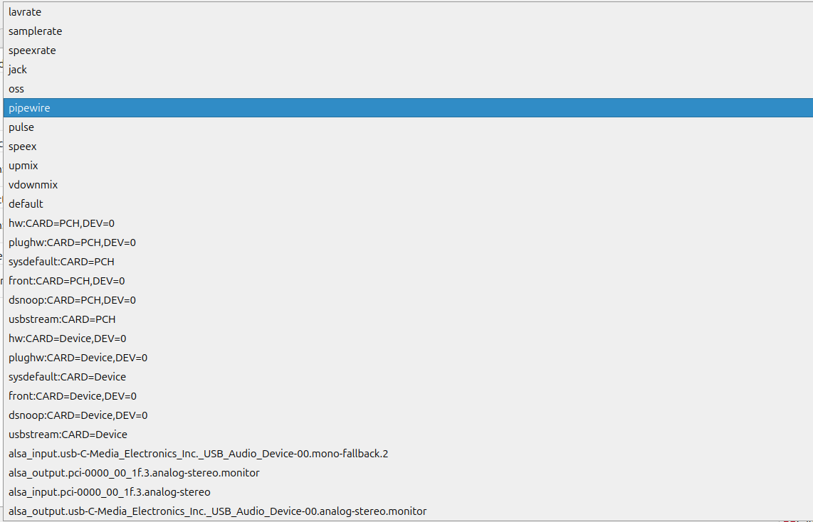

Not obvious choices, but I’d start by trying entries beginning with “alsa_”.
C-Media is the manufacturer of the audio codec in Digirig so that’s a match.
I have tried that but no luck. Thanks
