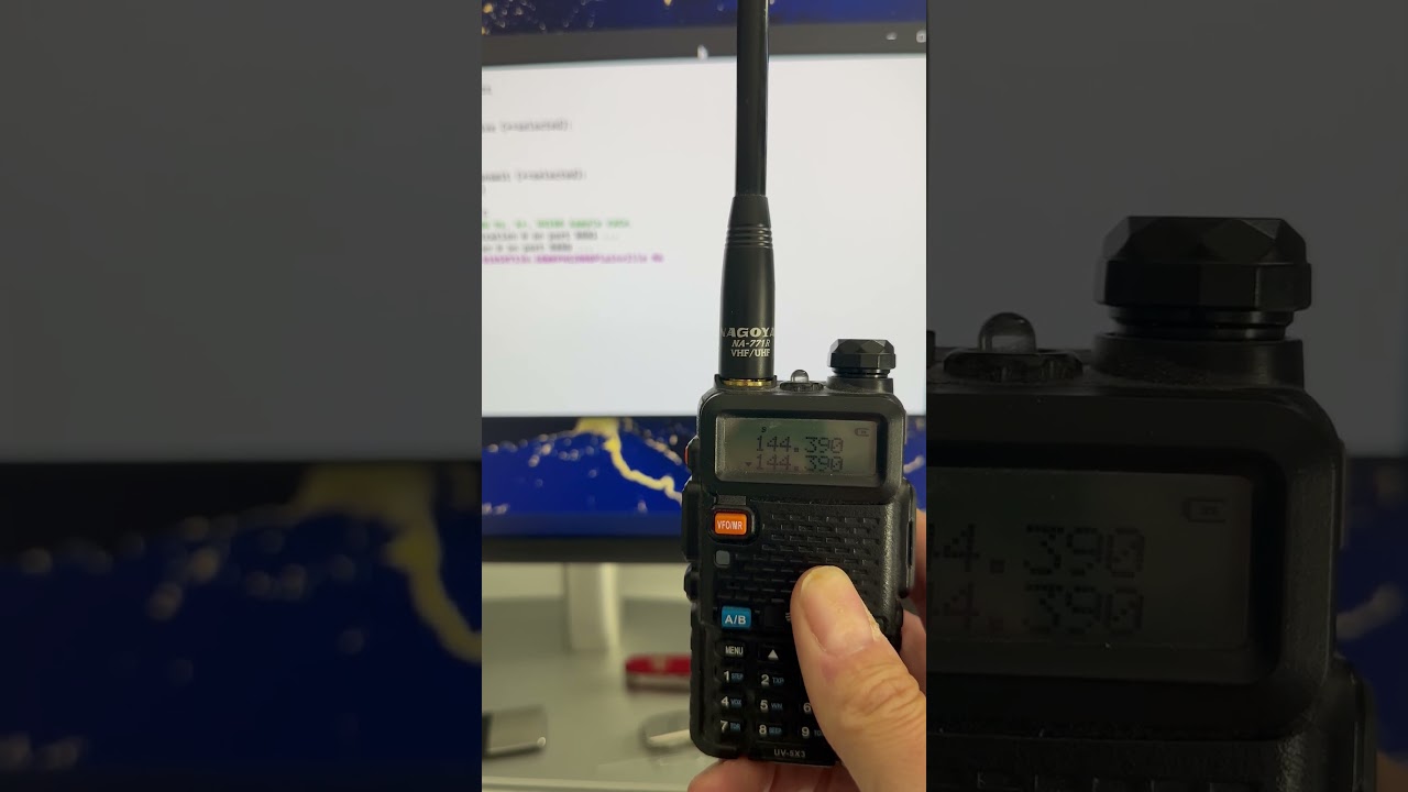

I’ve got a Baofent UV-5R plugged into Digirig (with official cables) hooked up to my linux (ubuntu) box running direwolf. Direwolf can trigger the PTT and I can trigger the radio using wsjtx too.
At the configured time interval in Direwolf, there’s a very short keying of the mic and a short transmission. Honestly, it seems like it’s just keying the mic and then releasing it without transmitting but since I don’t know anything about digital modes I don’t really know. Here’s a brief video of what’s going on:

The APRS handshake signals are short duration. If your outgoing signal reaches an APRS digipeater, the digipeated signal is likely to be received and heard by your transceiver. I do not hear a digipeated signal corresponding to your outgoing signal. Either a signal did not go out, or you are not in range of an APRS digipeater.
The radio you are holding is a monitor radio, right? Because I do not see any cable connected to a Digirig.
Is the transceiver antenna separated from the HT? That can cut down RFI if that is a problem.

Thanks Constrained. Yes, the radio in the video is a 2nd Baofeng that I have just to monitor the frequency.
