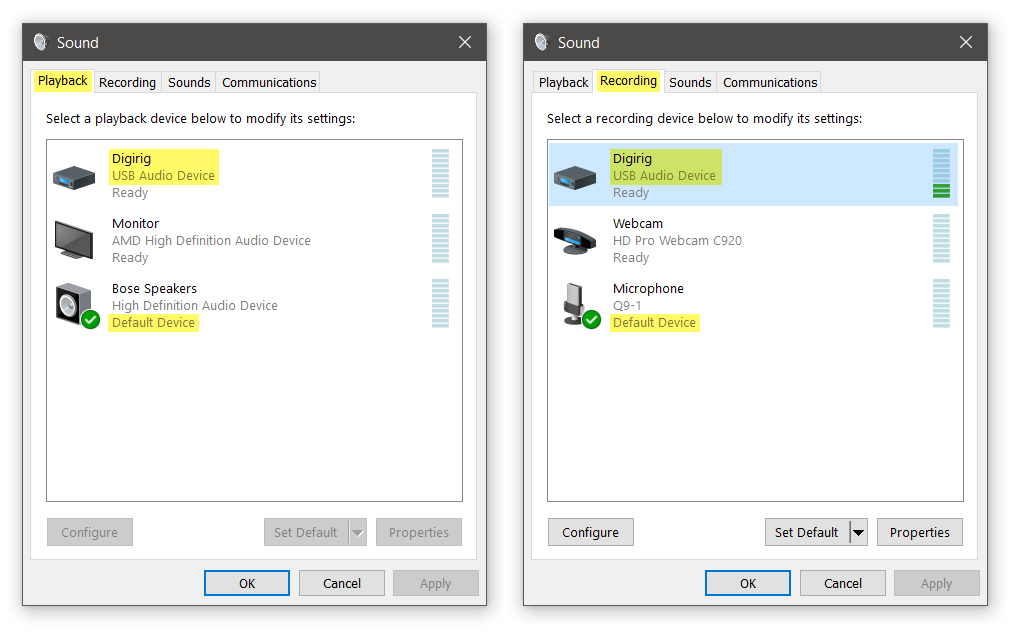

Do you see Digirig’s audio components in the control panel? You might want to turn on visibility for the disable devices in case you accidentally disabled Digirig’s playback or recording devices.
Look for entries with description “USB Audio Device”.
At the texas station, I see the dr 891 in both. I have unselected the digirig from being default. But, the microphone portion i cannot seem to figure out how to get it not to be default. I have not other devices to select has default for a microphone.

I can receive and decode, but no transmitt. The dr 891 is not set to default as speakers, but is default as microphone. I dont see any way to change the digirig away from default as there are no other microphone devices.

If you don’t have any other recording devices it’s ok to have Digirig as default.
You certainly don’t want to send the notifications audio into Digirig’s playback device.
