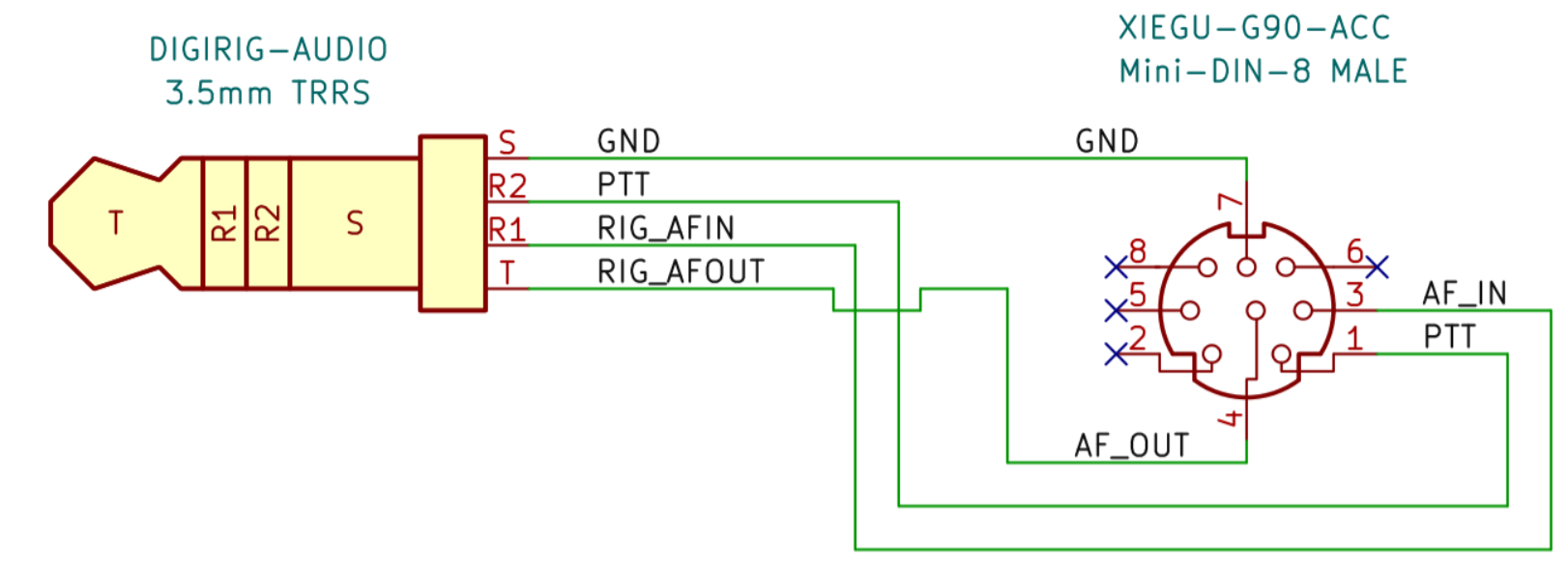

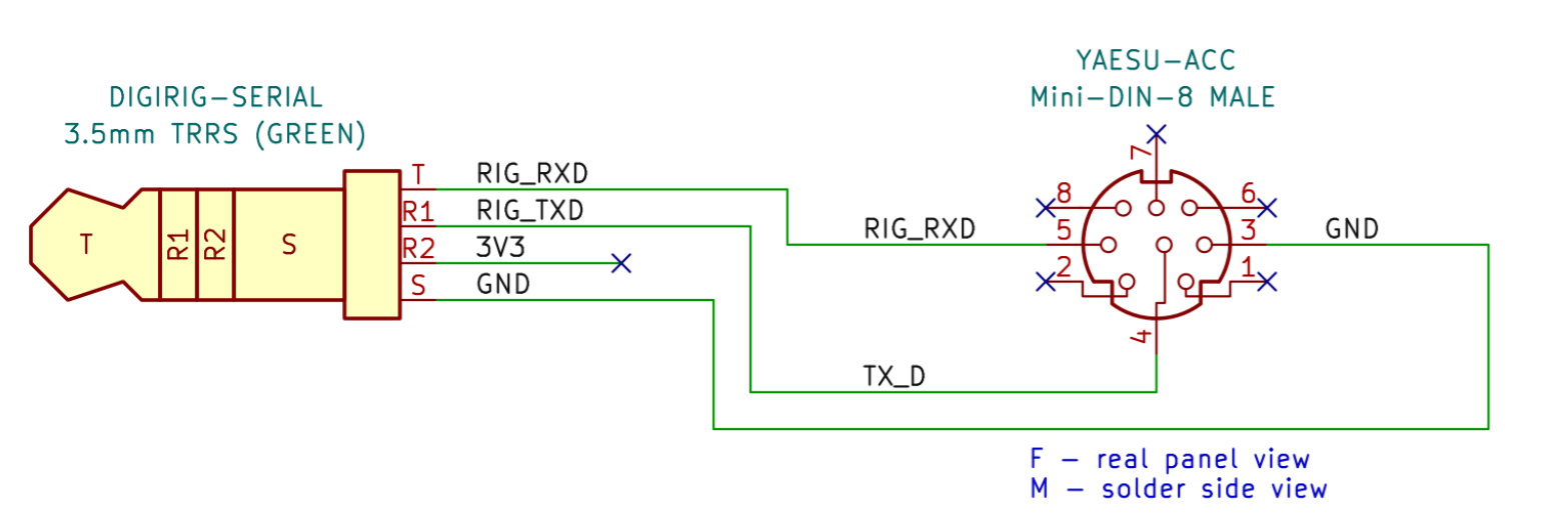

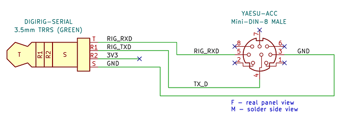

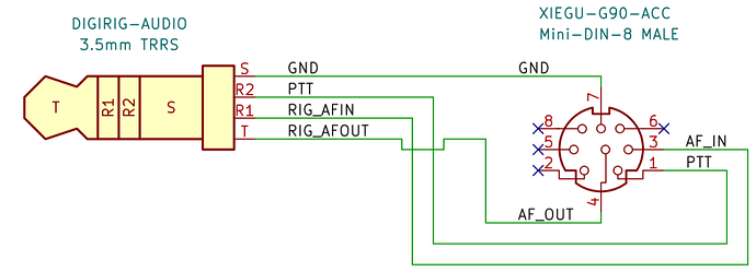

It is not. G90 cable is audio/PTT while Yaesu cable is for serial CAT control.
Even though mechanically these two cables are the same, electrically they have different connections and purpose therefore they’re not interchangeable.
From: https://digirig.net/product/xiegu-g90-cables/
From: https://digirig.net/product/yaesu-ft-8xx-cables/
