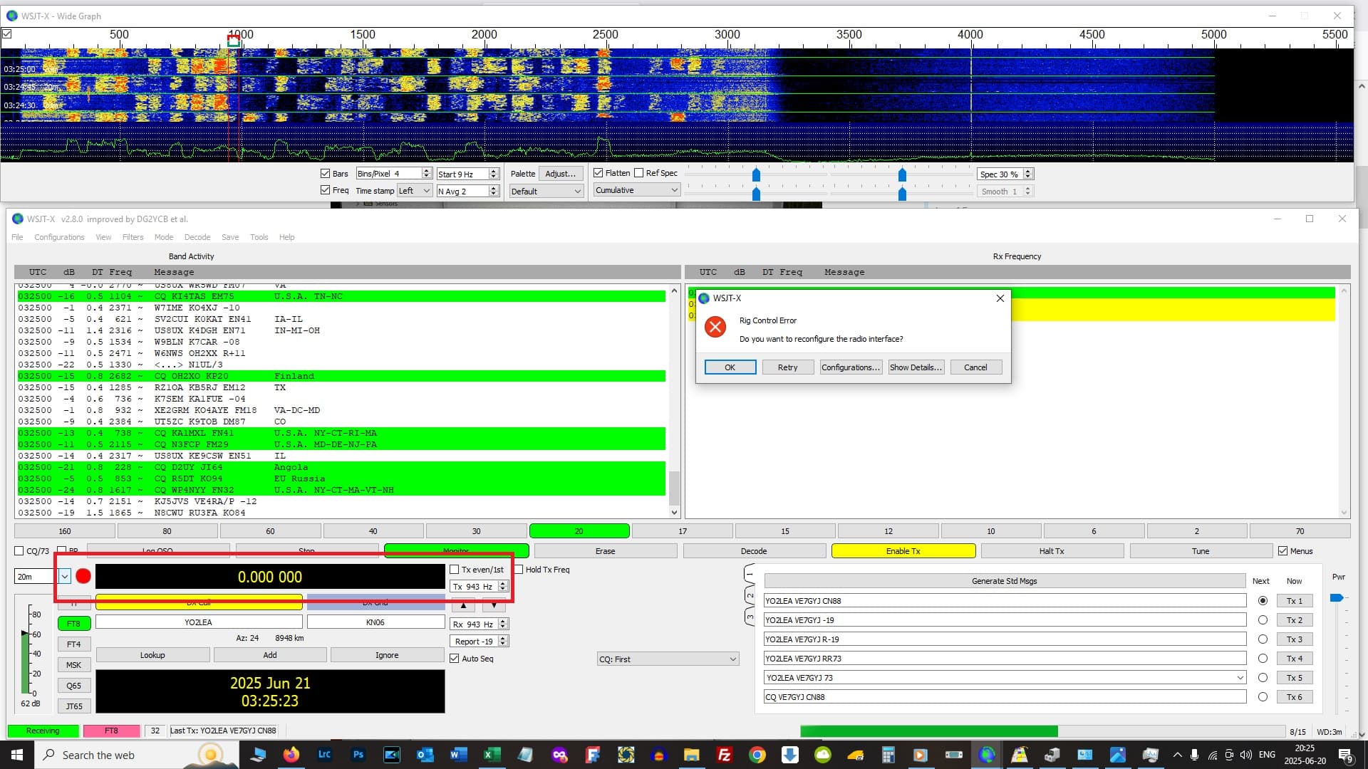

Another ‘Digirig won’t transmit’ topic, but with a slight difference. Everything was working fine a week ago. Flashed up WSJT-X and the G90/Digirig this evening and quick as a flash, ‘Rig Error’. The software receives fine, but won’t transmit. I’m not aware of making any changes to the radio that would affect this, but with ‘Rig = None’ and ‘PTT = RTS’ things work just fine. NOT the end of the world, but it REALLY annoys when things like that happen and I can’t figure out why.

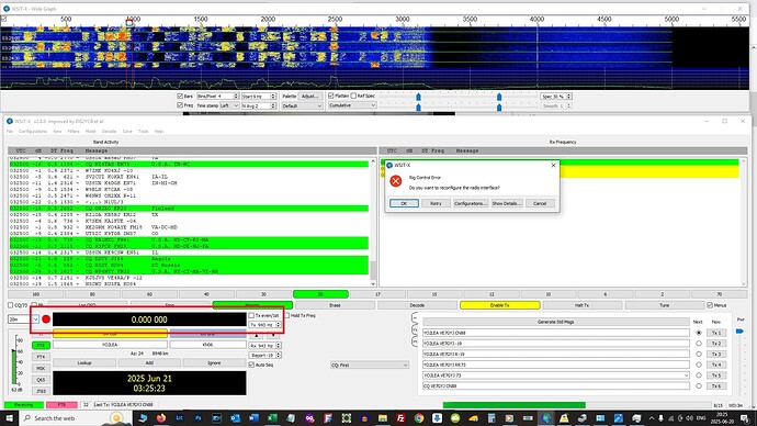

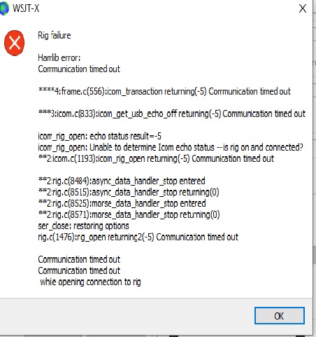

This is the rig error message I get when the software is set with ‘Rig = G90’ and this is my WSJT-X window:
It puzzles me that it’s receiving just fine, but not showing a frequency.

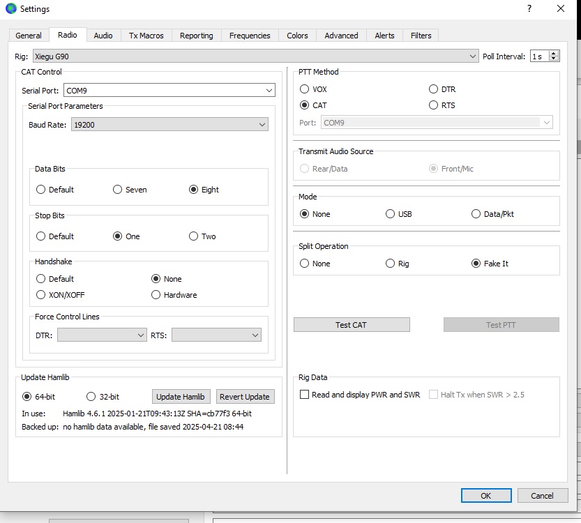

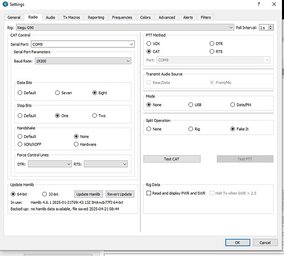

This is the config window (I’ve also tried other radios, no change)
Based on things working with ‘Rig = None’ I assume the Digirig and cables are okay. All my Windows settings are just fine and unchanged. I tried a couple of different USB cables from the computer to the Digirig as well as all the USB ports with no change.
