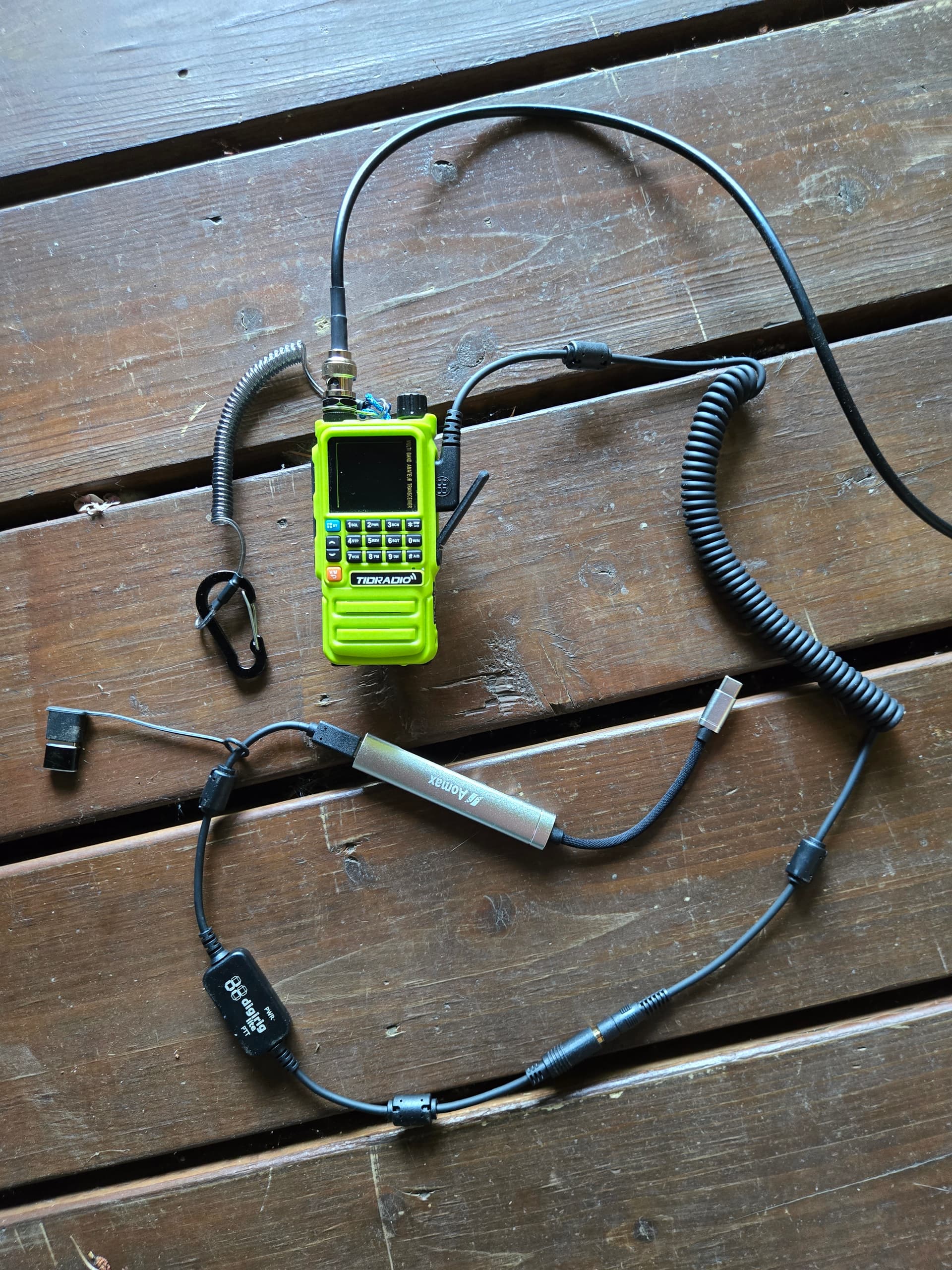

Added a $4 USB hub from Amazon and it now works with my S24. Bummed to add bulk to my setup, but it does allow me to charge my phone while using the digirig, so it’s not all bad. I did have to turn the volume way down on my radio though. Digirig works fine without the hub on my A9+ tablet.
