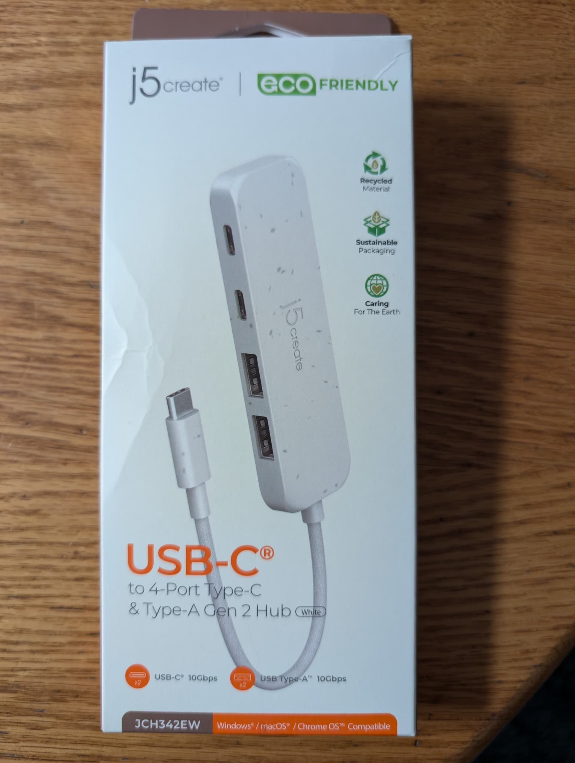

I picked this USB-C Hub up at the nearest Best Buy since they had it in stock. It is a bit big but was the only one in stock. Here is a picture of it.
Pixel 8 pro here as well with issues. Have any of the usb hub combinations allowed the digirig lite to show up as another sound source?
Adding a hub in between allows it to work, but its also screaming full volume over the phones speaker at the same time.
