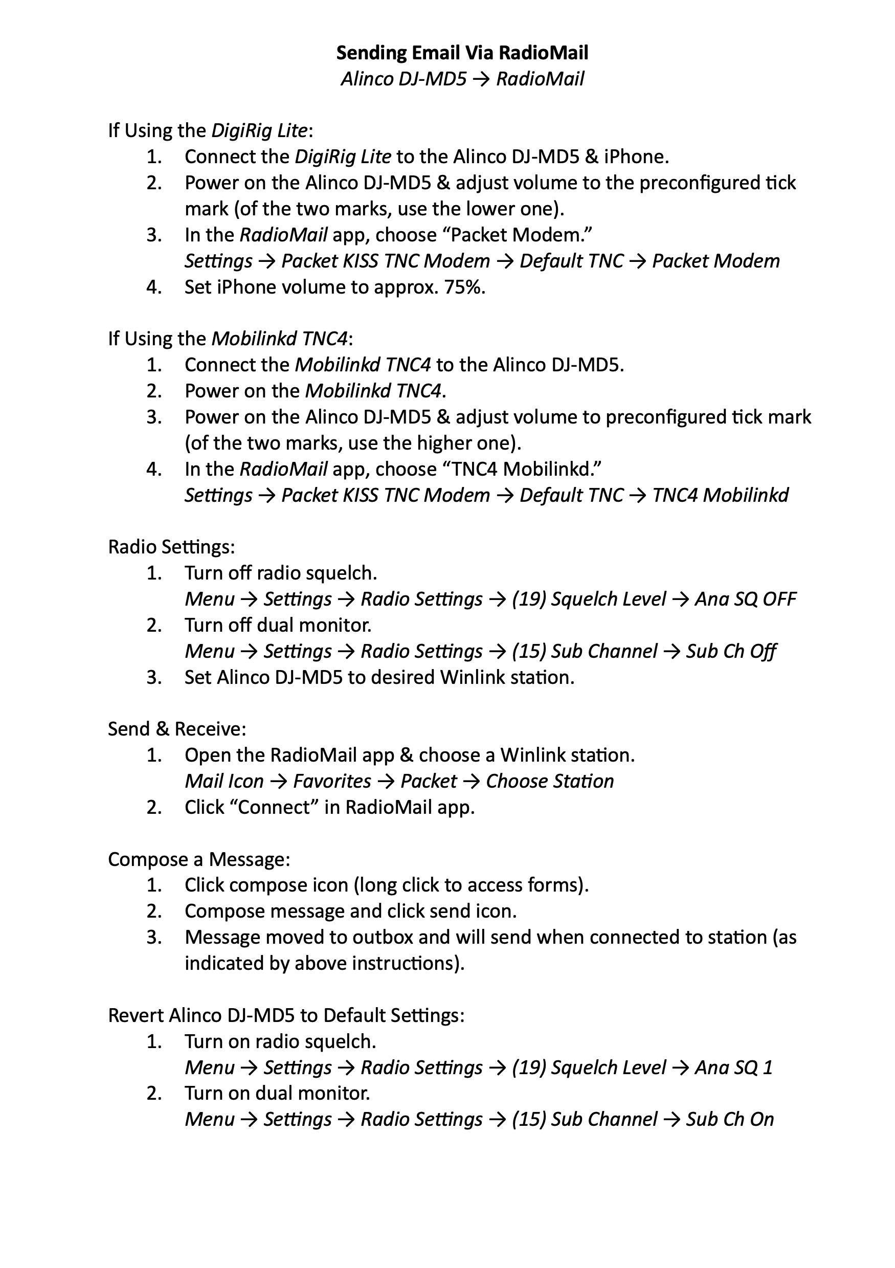

Here’s my instructions for my Alinco, should be similar on the Anytone…
Thank you very much. I’ve been through every setting I believe will help. Clearly I am missing something.
