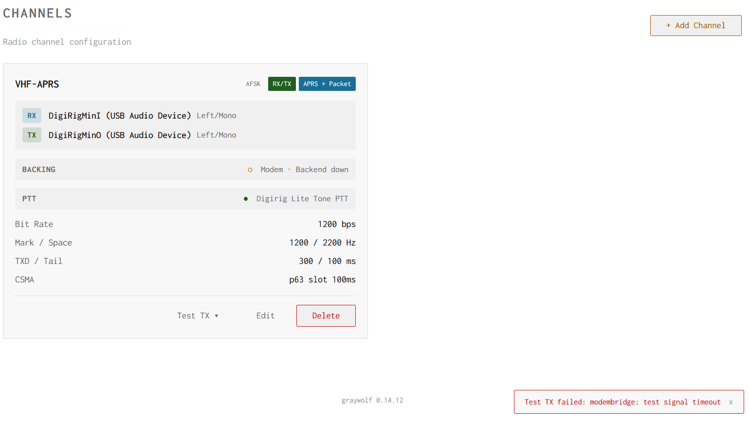

Trying to get it to work with Graywolf (v0.14.12) and it will not configure PTT correctly. I’m selecting the “Digirig Lite Tone PTT” for the PTT option. It only offers L or R mono audio channel and neither will trigger the PTT.

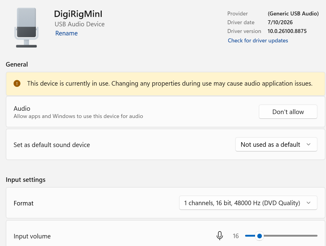

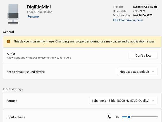

It doesn’t seem like it’s hearing either…I see receiving on the radio, but don’t see any packets in Graywolf. Is it interesting that the input audio channel is “in use” but the output is not?
Windoze Config

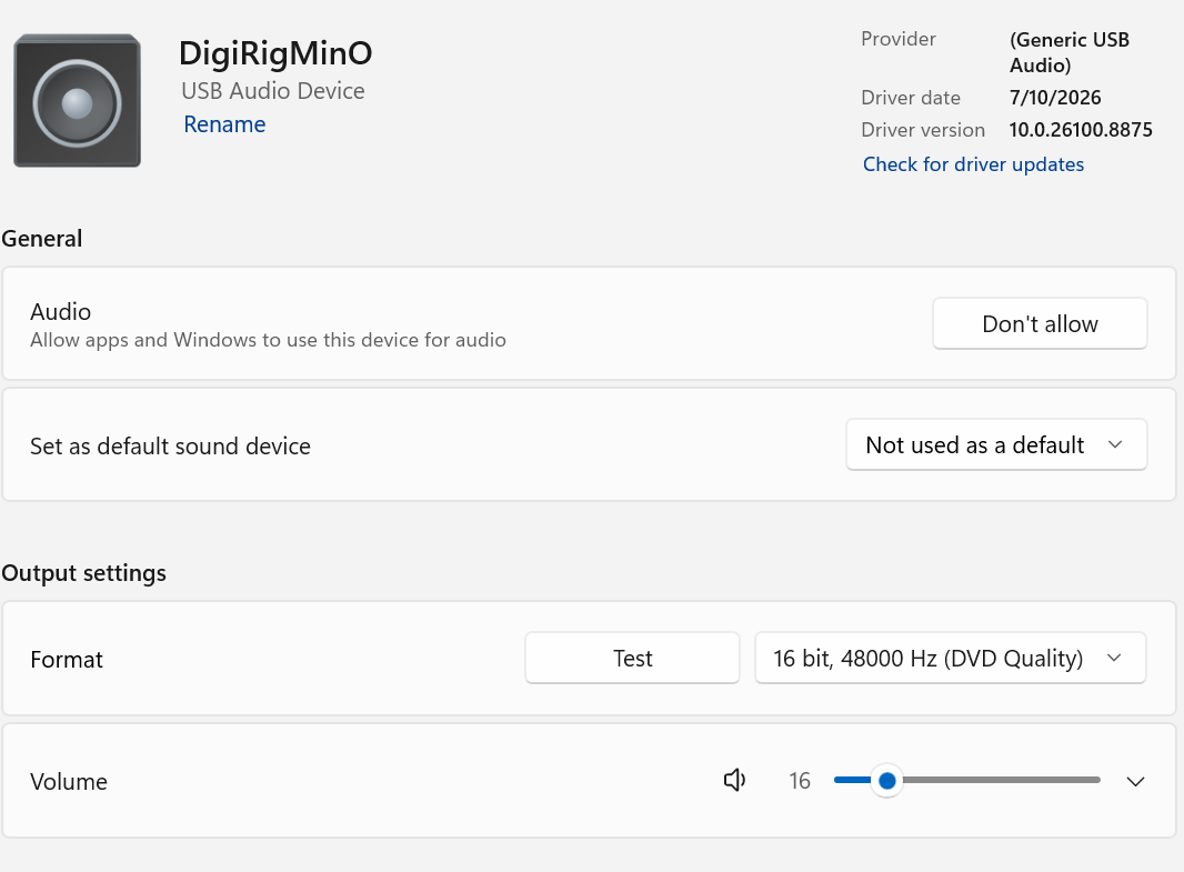

An additional data point (that points me towards a Graywolf config problem) is that if I go into to Sound Settings on the DigiRigMinO (output) device, and click the “Test” button, it triggers the PTT in the radio. Given it already works with VARA FM, that’s pretty much a smoking gun in Graywolf’s hands. Likely a loose nut behind the keyboard configuration error.
All I had to do was stop and restart Graywolf…
