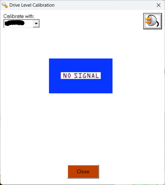

Hey y’all.

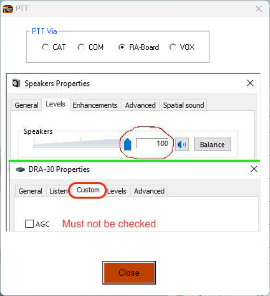

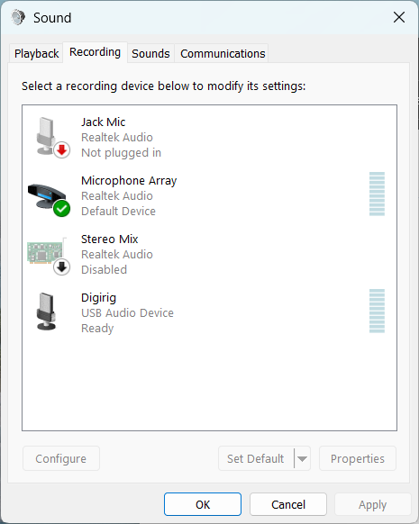

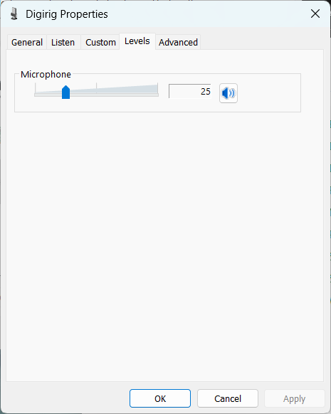

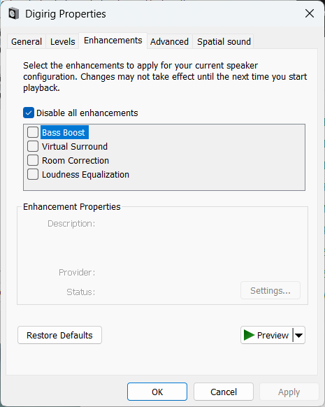

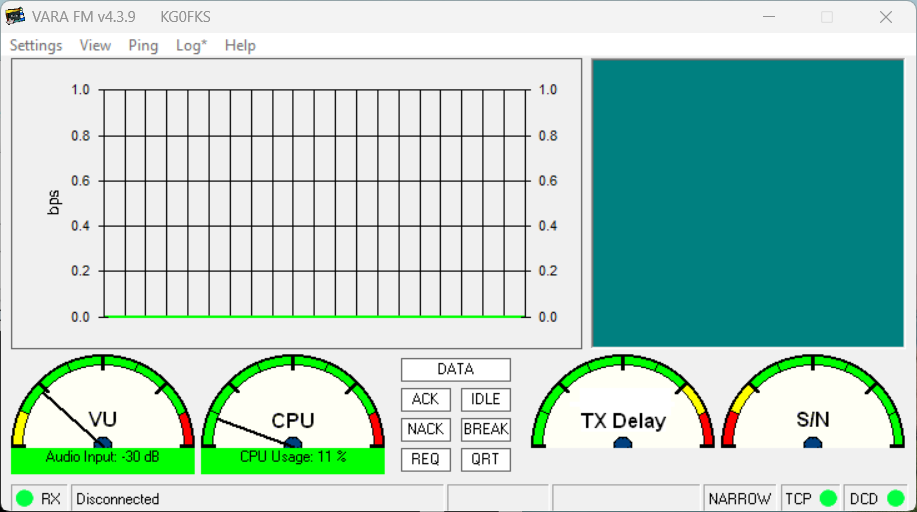

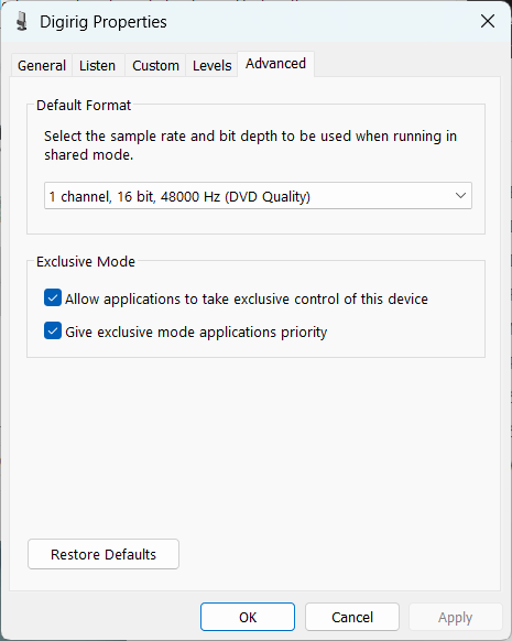

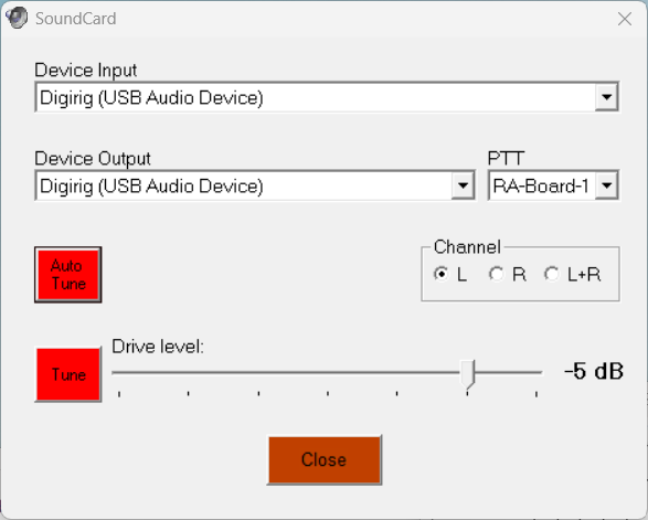

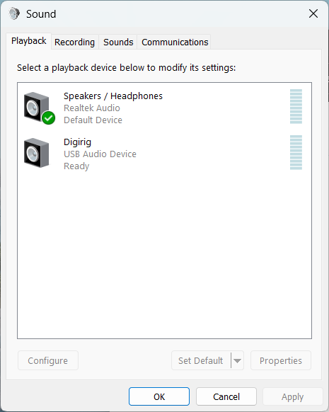

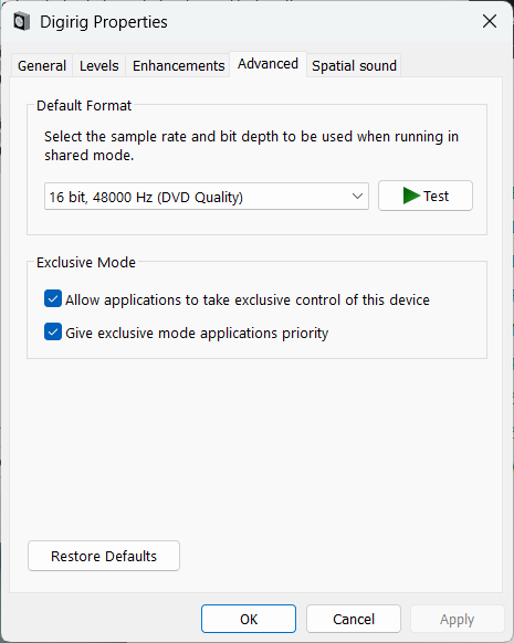

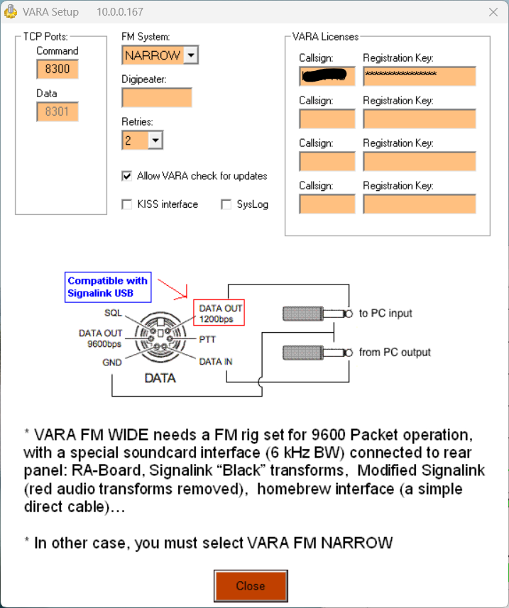

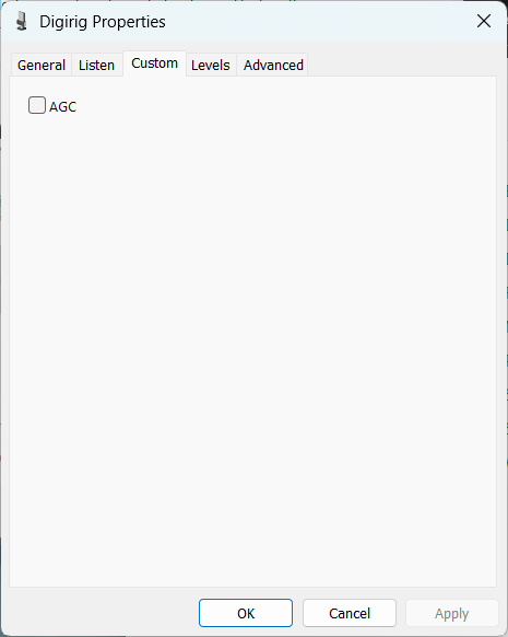

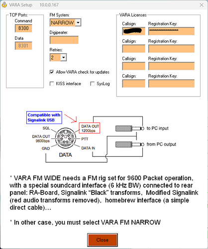

I’m getting a No Signal result with VARA FM Autotune. I’ve double checked all of my settings, but I’m at a loss as to why I’m not getting a signal with my FT-8900. The frequency is correct, and the callsign is correct. The radio is keying up and I can hear the transmission on my HT. I’m just not getting a response. I’ve posted screenshots of my settings below. Any help would be greatly appreciated.

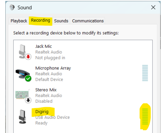

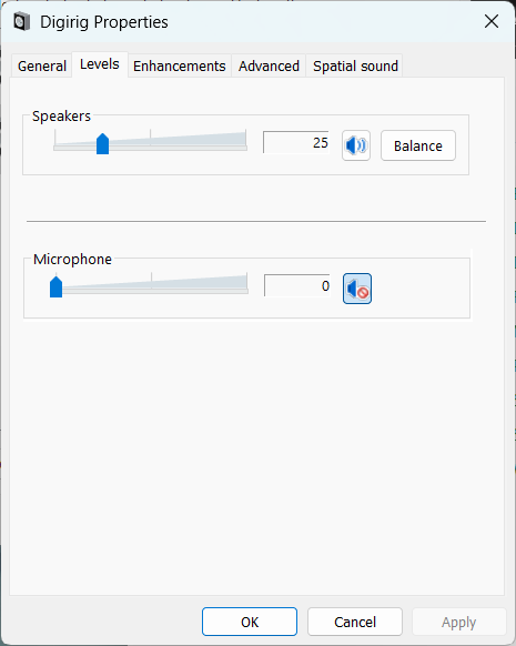

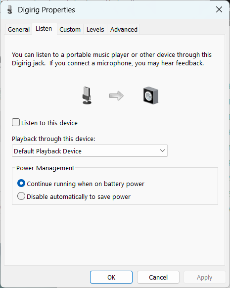

Do you hear the traffic from other stations on the frequency on your computer through Digirig? You can use “listen” feature of the recording device to patch through the incoming audio.
From the screenshots it doesn’t look like the audio is making to the computer. You might want to check the connections and confirm that the squelch is turned off:
That got it. Thank you very much!
