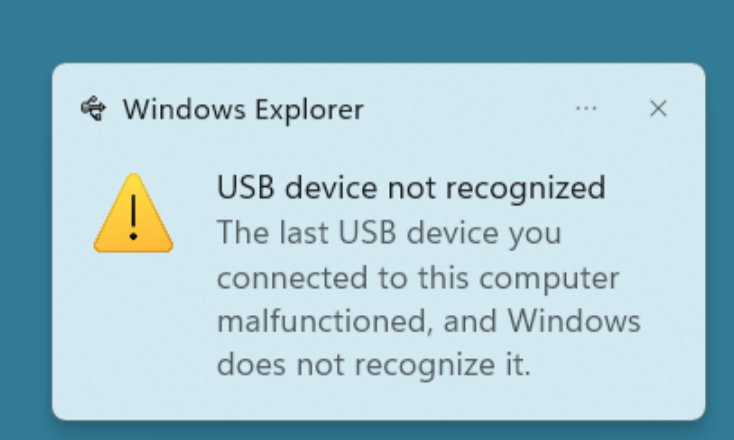

A few seconds after connecting the DigiRig Lite, this message appears:

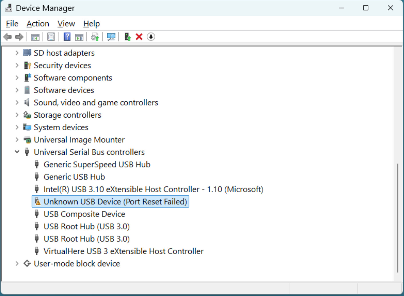

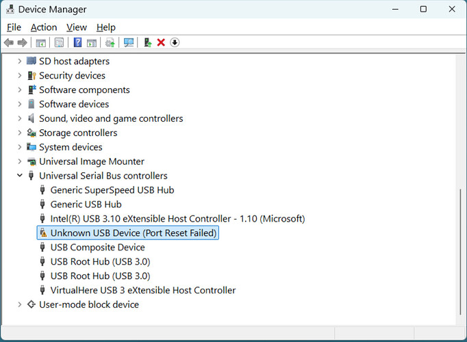

and the Device Manager shows “Unknown USB Device (Port Reset Failed)”:
