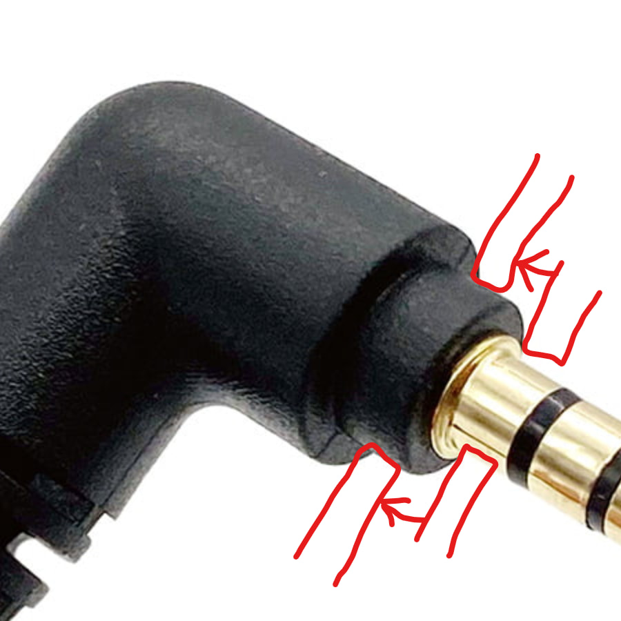

With the radio being brand new, the rubber ring in the socket that is supposed to make it somewhat splashproof pushes the connector out. Try rotating the connector while pushing it in so the rubber ring climbs on the narrowed part of the connector’s molding.
I tried twisting while pushing in multiple times without success. I got out the xacto knife after examining the rubber gasket on the HT and made 5 radial slits from the outer edge to the inner hole. This let me get the connector in to make good contact without holding it in. However it is not well retained and will pop loose with a minor disturbance of the cable. Hope it will improve with use and time. Thanks Dave
