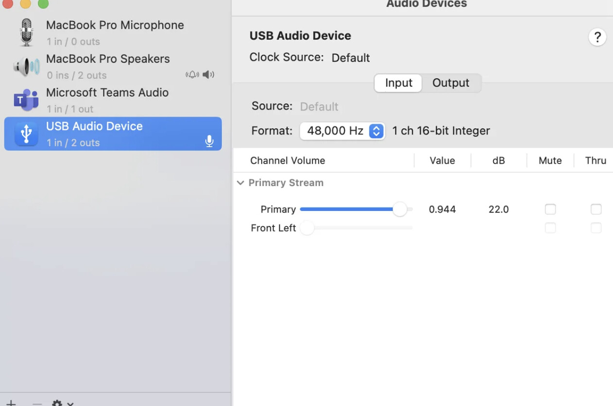

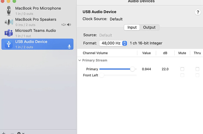

  • USB Audio Device configured at 48,000 Hz, 1ch 16-bit Integer

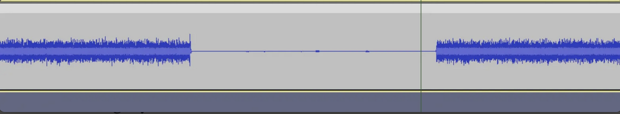

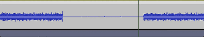

  • When receiving transmissions from another radio on the same frequency, the audio in my Mac recording is extremely weak
  • The Audacity waveform shows mostly static with a very faint signal where the actual transmission occurs

  • Confirmed my audio settings in macOS (USB Audio Device is properly selected)

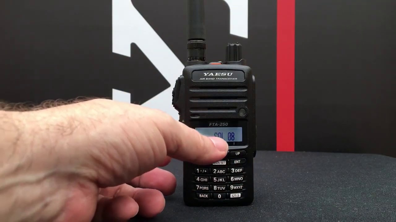

I found the Squelch setting on my radio - once I increased that I was able to clean up the signal significantly. Sharing this in case anyone runs into the same issue. thanks!
