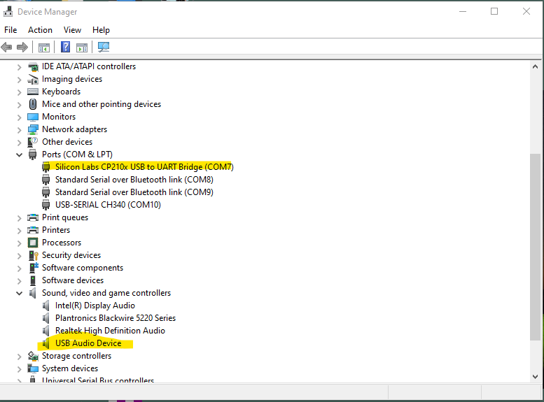

I have a Yaesu FT-100 that I’m using for portable ops, I have winlink running on a Digirig. I had it working on Vara FM, but I cant seem to get it working on Vara HF. I have tried almost every option, If I “tune” on Vara FM radio transmits.
If I “tune” on Vara HF nothing. If you can share your settings or suggestions…
Thank you…John

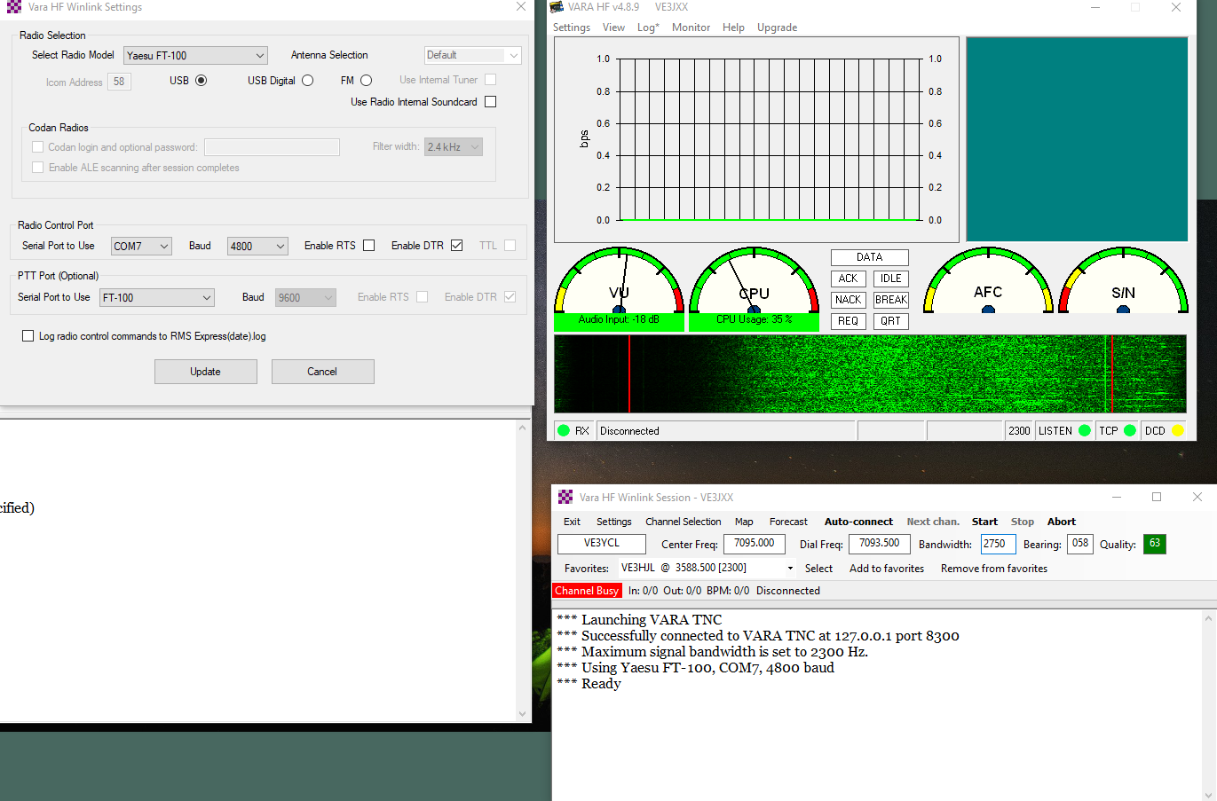

Yes, let’s start with PTT.
Please share the screenshot of relevant VaraHF configuration.
I purchased the “Yaesu” cables along with the Digirig.

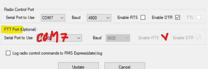

The PTT doesn’t appear to be configured:

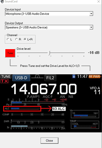

If you still encounter difficulties, here’s the detailed FT-100 setup tutorial for another HF mode which you can use to rule out any hardware related concerns.
I think that worked! Thank you K0TX…
