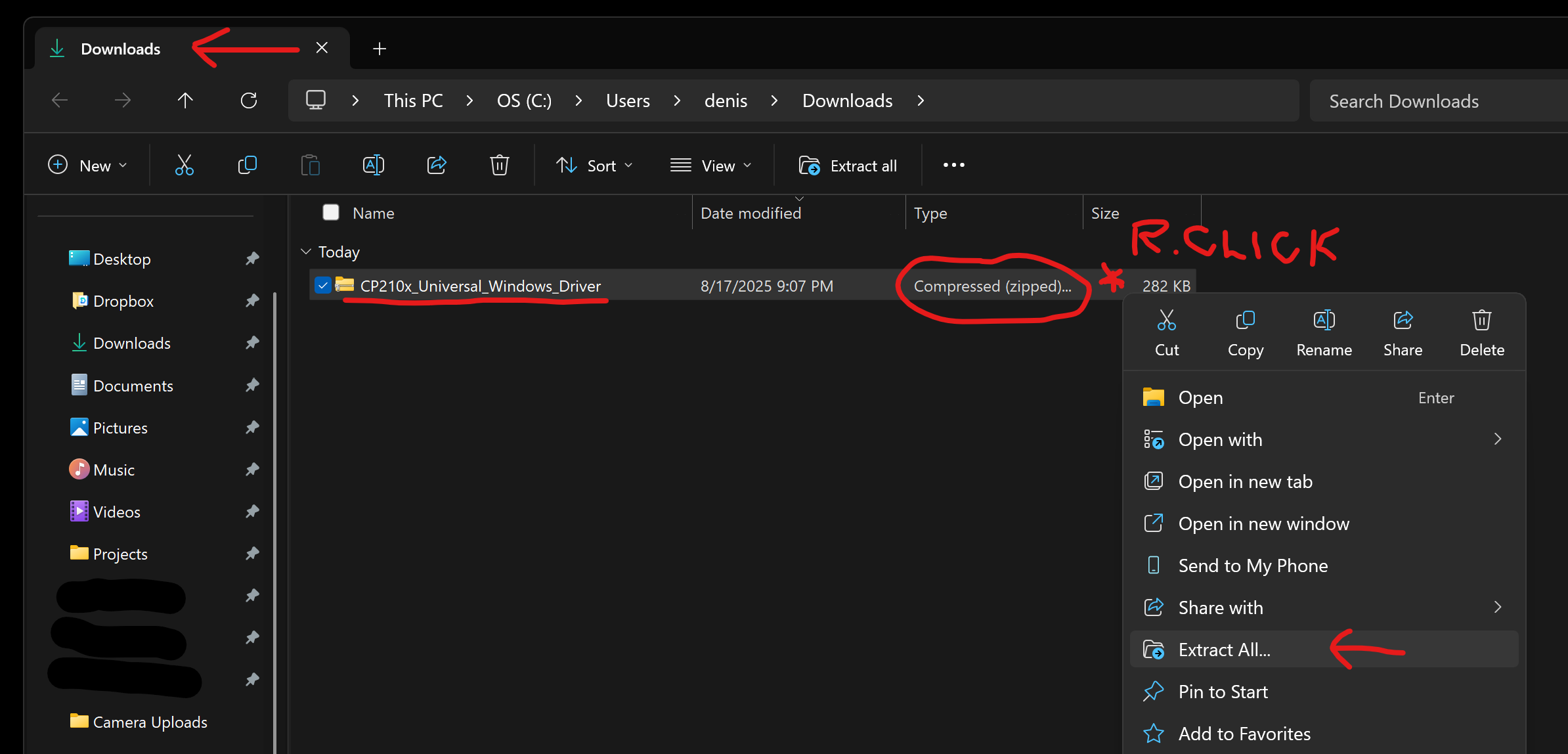

Hi, The post by VE3IIF is very helpful. Digirig,FT857D and my Windows 11 was all working last year. But after a reinstall of Windows 11, I can not get the resulting pop up with “install”. The zip is only a text file which I save without success. The pop up says “Open” and does not offer an install option. I’ve tried saving many times but windows doesn’t install the driver. Windows does recognize the sil…url but can’t complete the driver update. Any suggs appreciated. Patience in all things, especially Digirig. Mike W3PDR
The archive with the driver needs to be extracted first. Then the context menu (right click) called over the file in the decompressed folder will have “install” option in it.
K0TX…thank you kindly for your reply regarding the driver update needed for WSJTX. A windows procedureal problem on this end. The driver installed nicely per your instruction. Regards and best 73s Mike W3PDR
