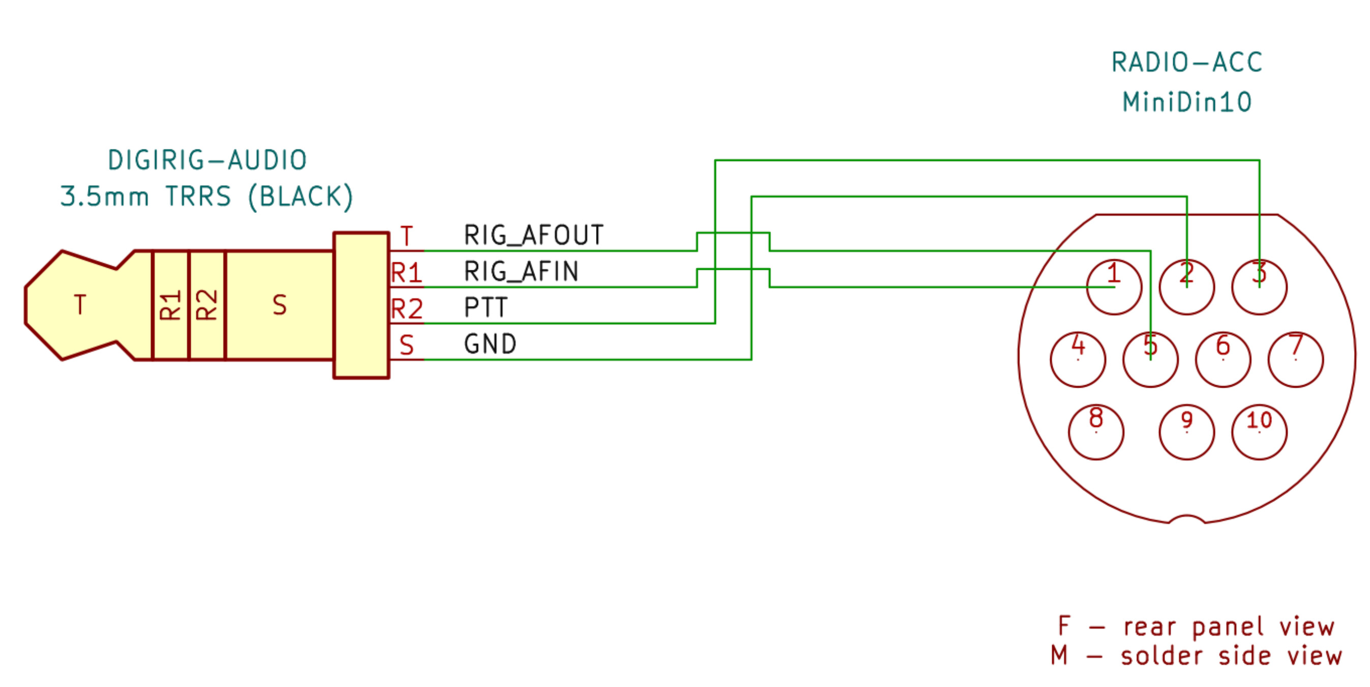

I have done all of these. I agree the problem is with the echo link app. If I set the app to use VOX it starts to transmit the audio from the radio which is tuned to the weather frequency. As son as I change the radio to a frequency with no signal I get a horrible buzz like an open ground might happen. If I change to digital control in the wizard I get no audio sent to the client. It’s almost as if the audio lead used to receive from the radio switches to something else on the Yaesu FTM400DR. On the Yaesu ten pin audio out should be pin 5 1200. Are you using that pin in digital mode? Or should I be using Link mode?
On 9600 baud cable pin 5 is unconnected. For the voice applications, the 1200 baud cable may be a better option:

Both Yeasu cables fail to key my Yeasu FT400DR and transmit audio from client to echoilink server. Tried both and I am returning products to Amazon. VOX fails because FT400DR has VOX only if bluetooth board is installed. 10 pin 96đź« 00 cable fails because it gets terrible hum receiving the audio from the radio when there is no audio. It works when audio, like wx channel.
