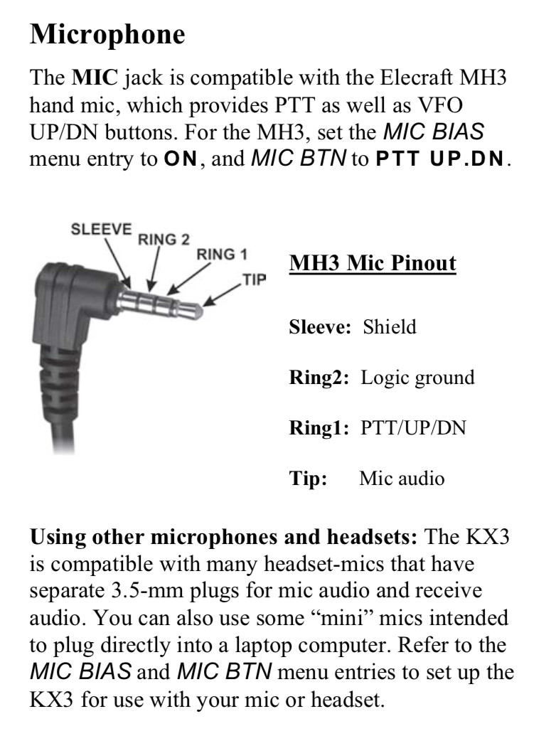

The Digirig Mike cable for the KX3 is TRS while the KX3 jack is TRRS.

Why is the Digirig provided cable for the KX3 TRS and not TRRS? Did I receive the wrong cable?

Digirig cable connects the sleeve and ring 2 together in the mic socket so the TRS connector is sufficient in this case:
If you suspect the issue with the cable, you can check the continuity against the schematic published in the product page.
