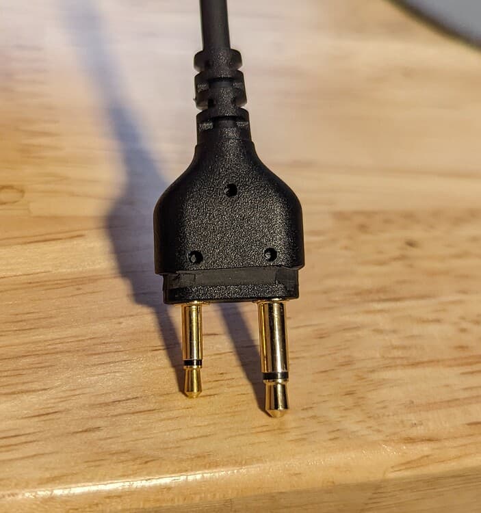

There were updates to the cable so it will likely work out of the bag. Here’s example of the modification to the earlier revision from this thread:

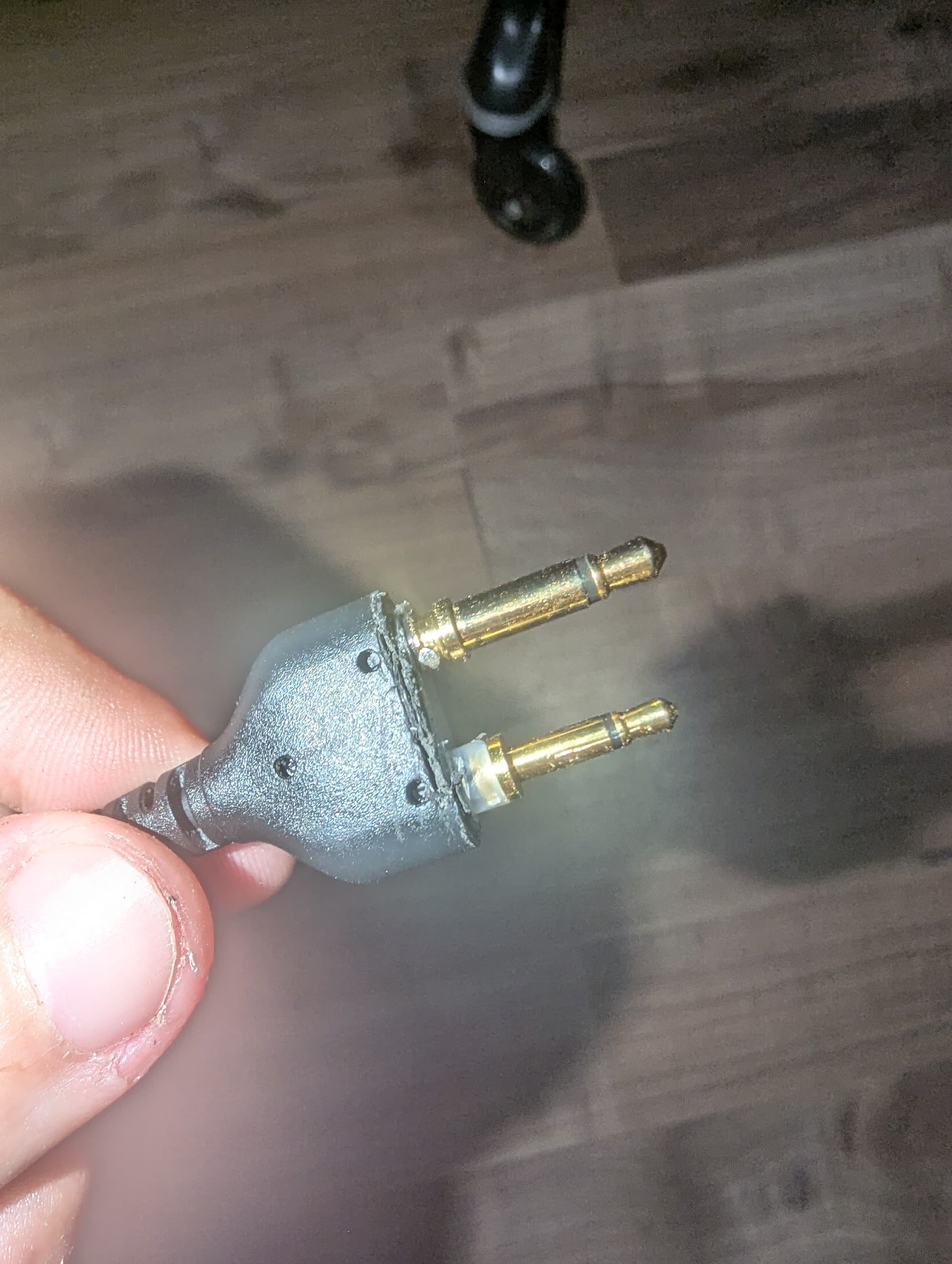

I clearly didn’t realize how much I was cutting and ended up just cutting off the entire protective ring on accident… Now it definitely plugs in all the way, but not sure how long it’s going to last me until it breaks with how deep I cut it…
I hope I’m understanding correctly here, but the Digirig cable has gold contacts.
If you’re looking for the ID52 itself, it looks like it’s silver.
Hope that answers everything!
That connector got quite a haircut :laughing:
PM me if it stops working.
I ordered a cable for the Icom ID-50 at the end of last year (2025). I can confirm that a) the cable has NOT been modified, and still does NOT seat in the radio deep enough to make contact and b) a simple surgery IS sufficient to modify the plug. I carefully removed 1mm from the plastic shoulder of the plug (it looks like the first example in the thread above, and not as severe as the second example). You can go on Denis’s YouTube channel to find the simple test of shorting the 3.5mm plug with a pair of tweezers to verify that the connector can initiate PTT. Since the surgery I’ve been using the DigiRig Lite to successfully work WinLink.
Yes, it would have been nice to see this manufacturing flaw fixed, but the repair is simple and Denis was very generous and patient in explaining it.

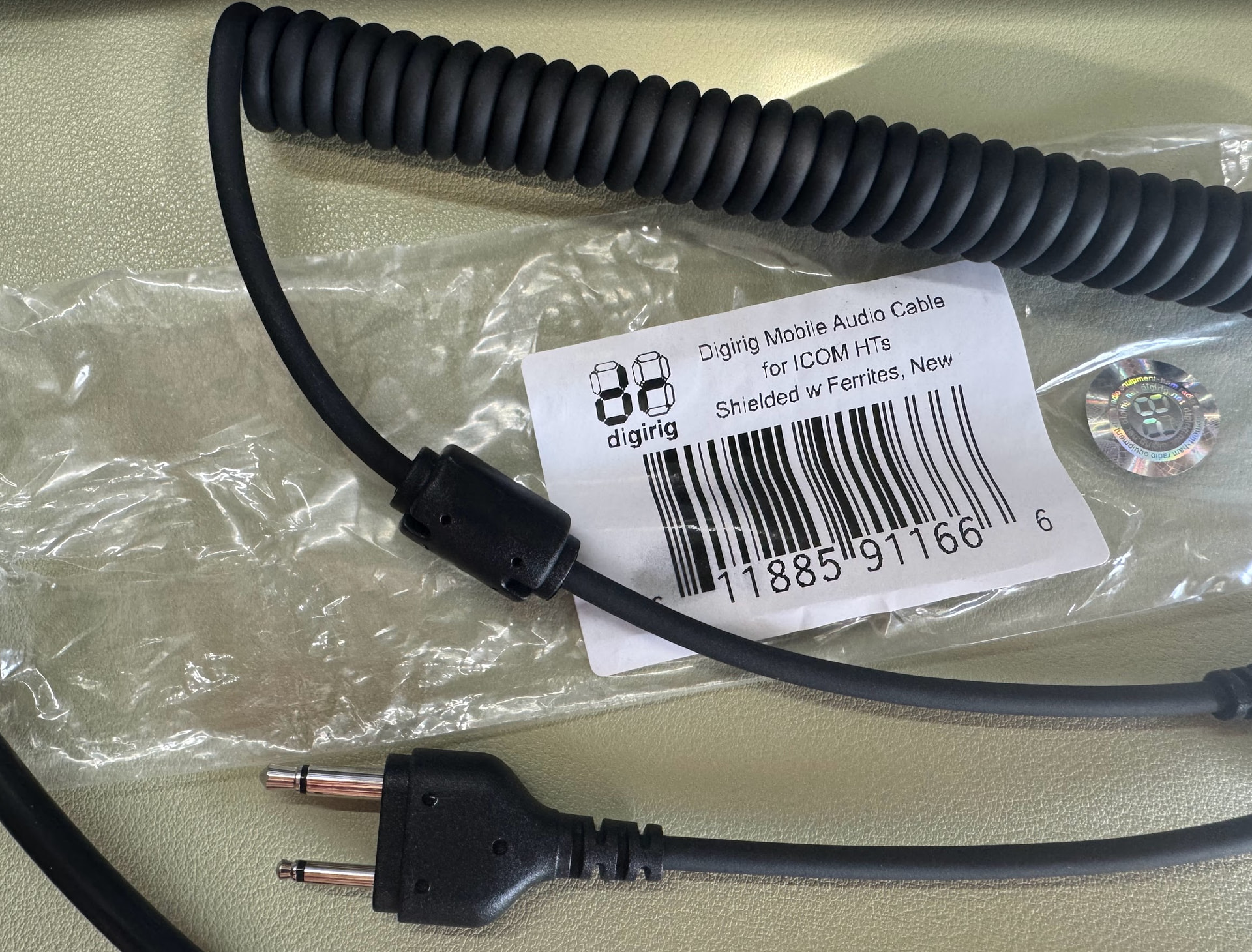

Hi. I just bought a brand new cable last week. The cable seems fit into the radio however as soon I plugged the radio goes to transmission 100% all the time. It does not matter if I plug the digirig in the other end or not. It could this potential partial fitting explain the PTT issue am facing?
Thank you!
Just in case, here a photo of the cable :
