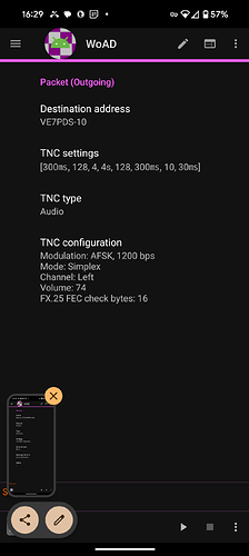

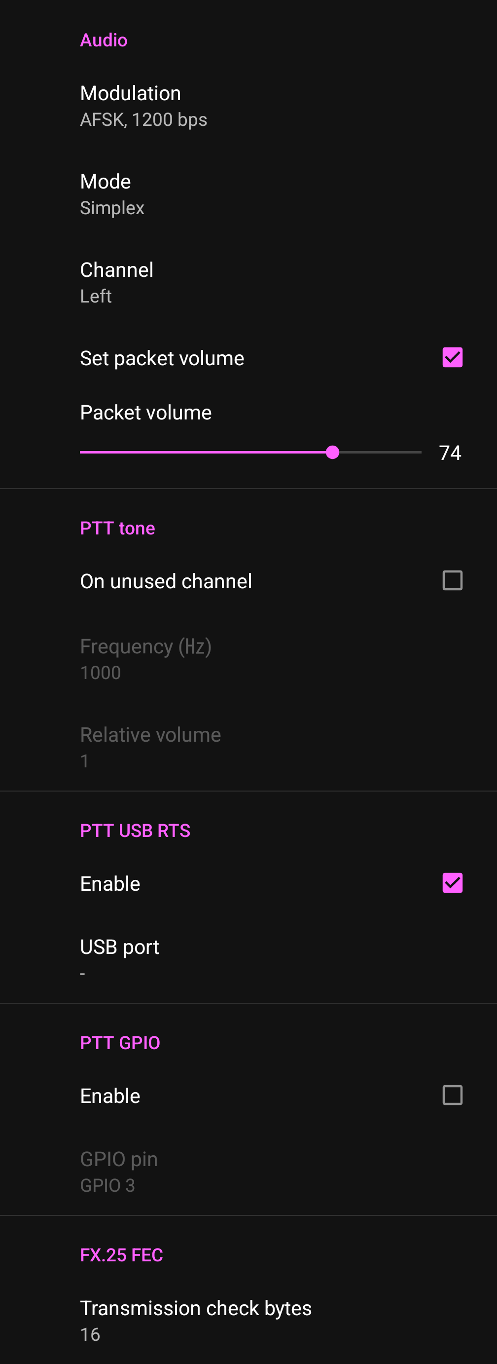

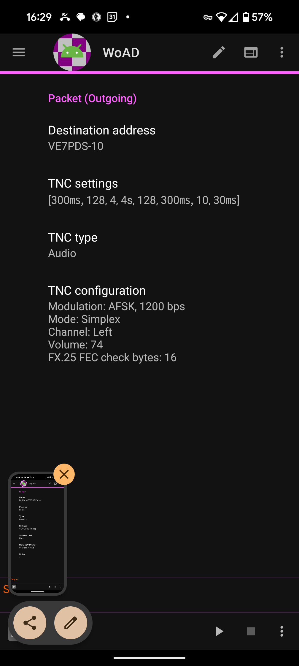

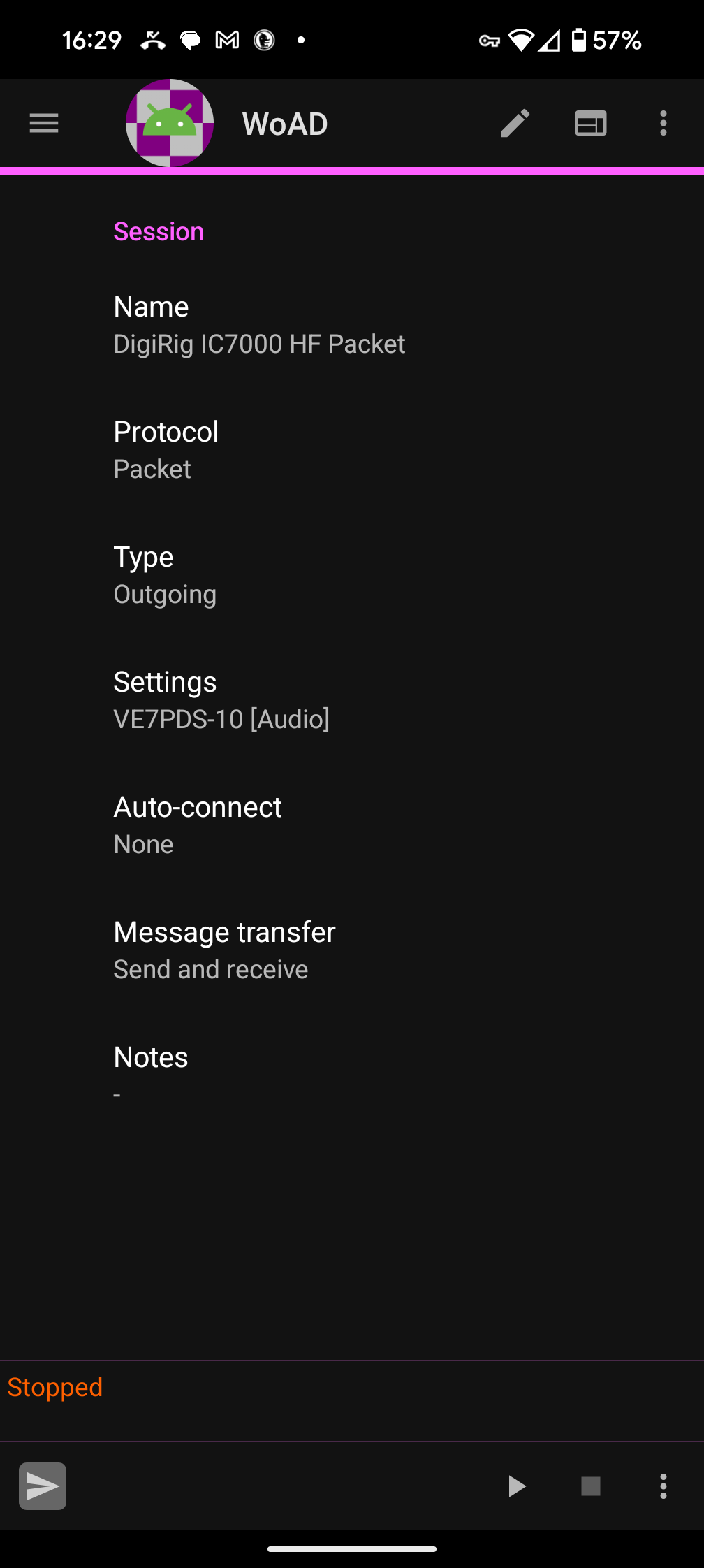

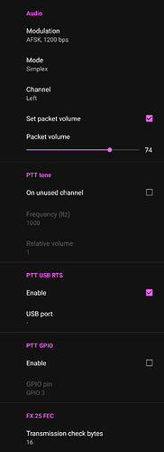

Here are screen shots of my WoAD Session settings. The audio level is pretty unforgiving, and I have the volume (speaker) level on my radio just slightly up from the lowest position. The same settings also work on my TidRadio HT.

Thank you, I’ll compare them to my settings. It keys the radio and transmits but never connects. I think it is something with the volume settings.
If memory serves correctly; I had the same results as you, and found setting the parameter FX.25 FEC to 16 made it work. No, I have no idea what the setting does :rofl:
Thanks the FEC setting corrected my issues.
