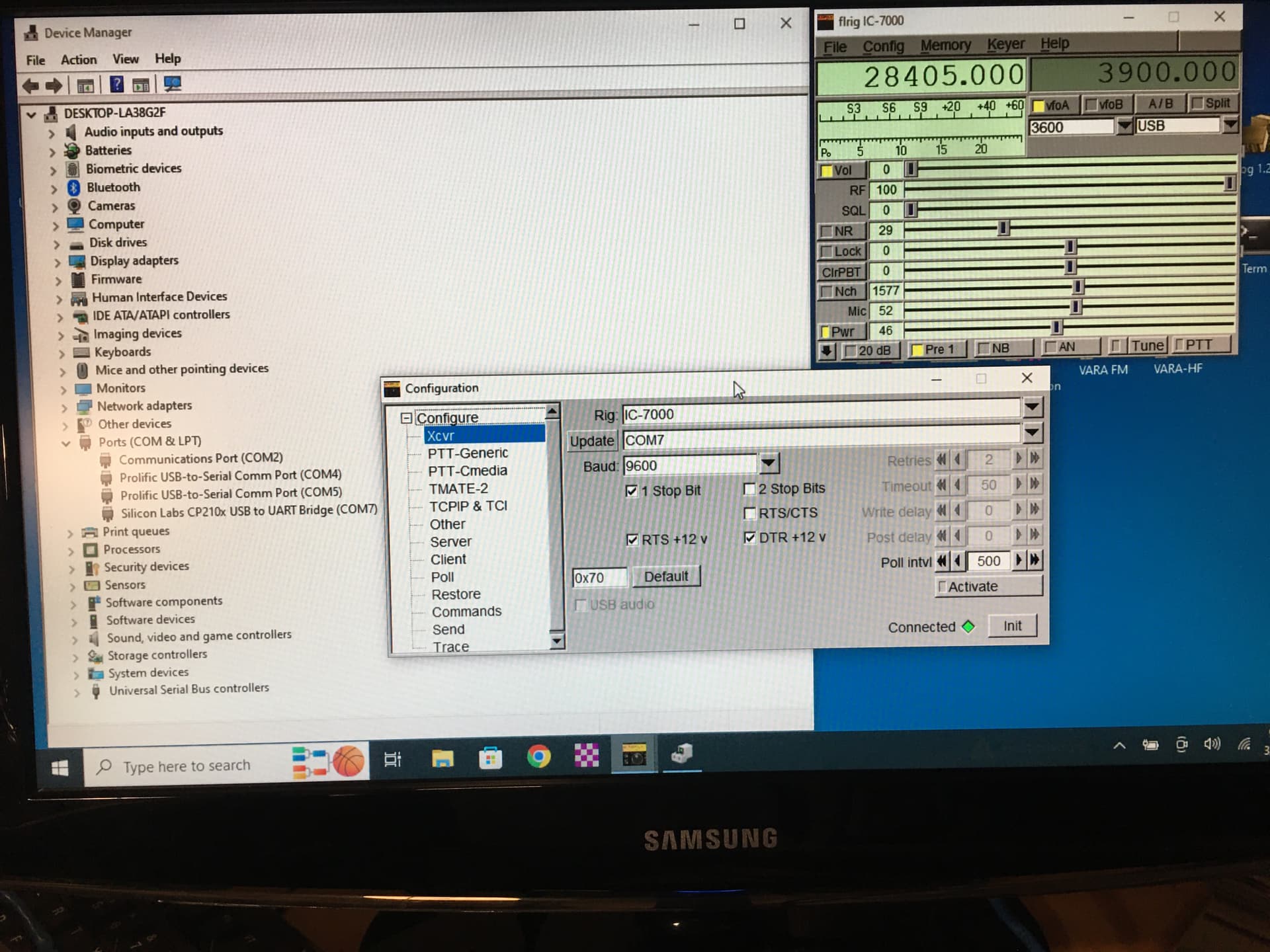

I could use some help with specific settings in fleig connected to a digirig connected to the data port of an Icom ic-7000. Current settings not working. Com 4 9600 8/1/none. In flrig xcvr is right ic-7000, update Com 4, baud 9600, 1 stop bit checked. Init comes up select separate ports. Under PTT-Generic PTT on CAT Serial Port all OFF and PTT control on Sep Serial Port Port Com4 RTS SET Dtr is OFF when I hit Init it changed Port to None. Dave K7GPS

In my Config Pic showing Radio and Comport settings I had
RTS and DTR enable. If you do that, at least on mine it locks the TX on.

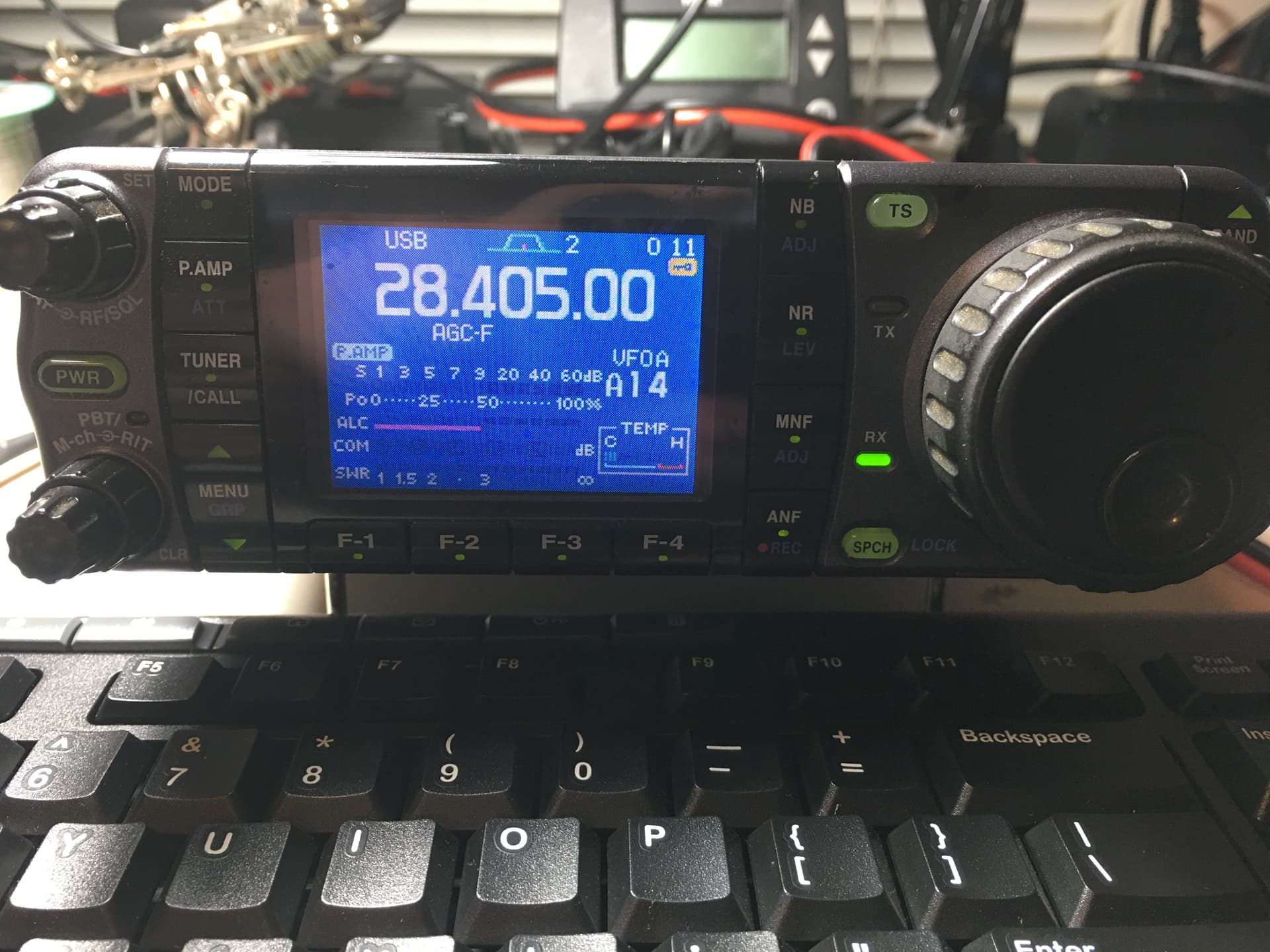

I had taken the Pic of the front of the Radio before the other.
Also I recommend setting the CI-V Baud Rate in the Radio to 19200.
I find 9600 is to slow. Be sure to reset in FLrig as well. Let me know how it goes.
