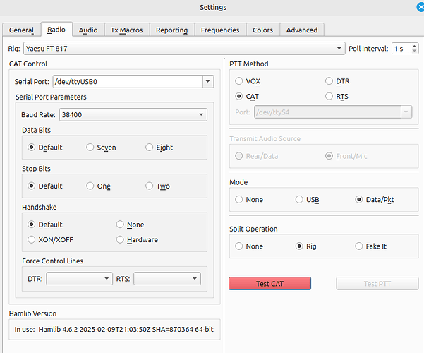

Try with the handshake explicitly set to None.
The computer may be trying to set RTS signal of the COM port which would in older day indicate readiness of the port to send data, but with Digirig Mobile that signal keys up the radio.
Good thought, but handshake None did not help.

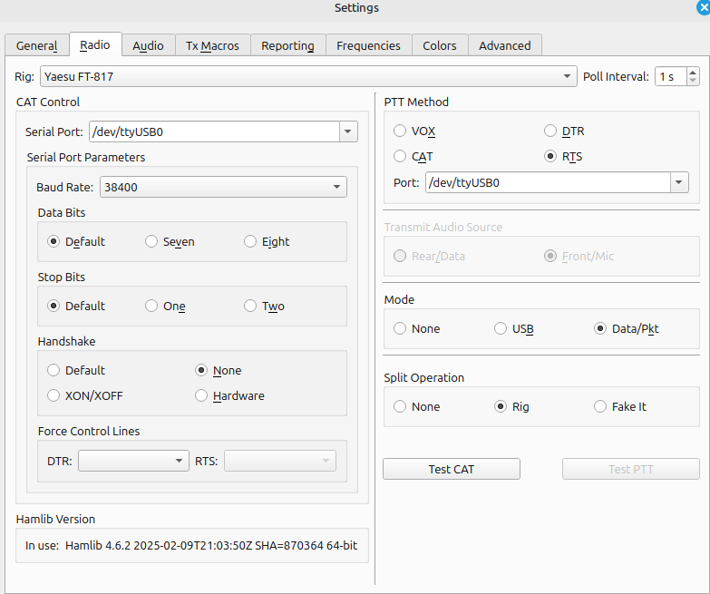

Try explicitly setting PTT method to RTS.

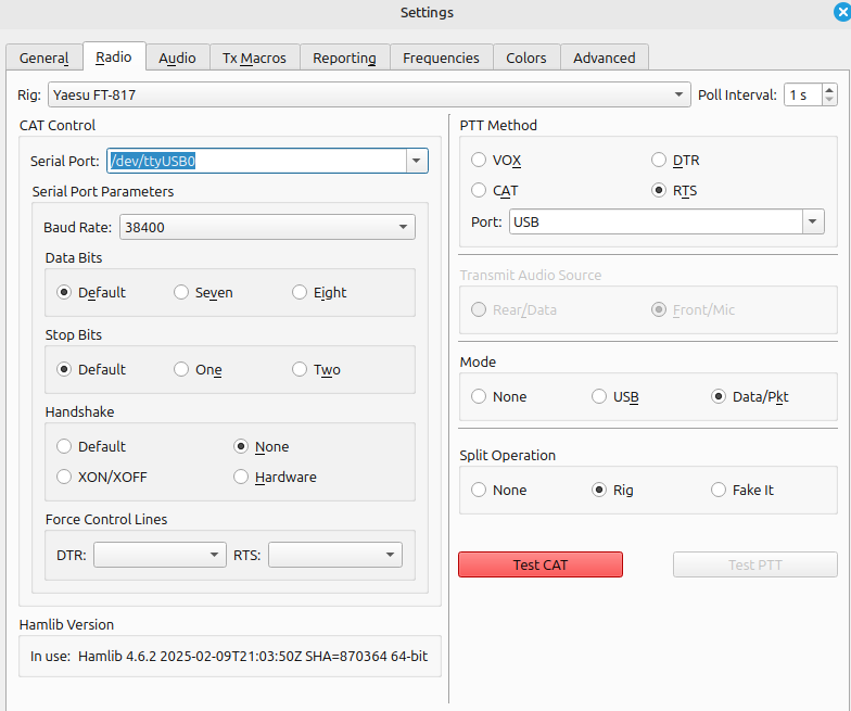

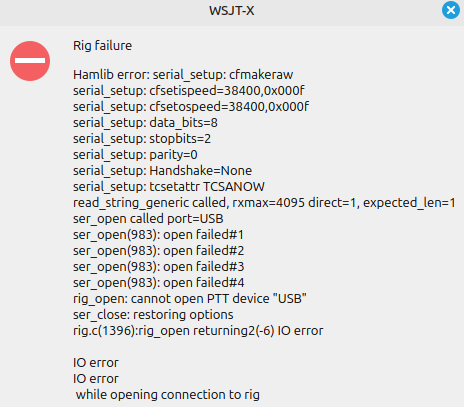

Sorry, I can’t figure out what port to use for RTS PTT, I cant use /dev/ttyUSB0 since that’s already in use as the Serial Port and I don’t get the option to pick it again for PTT. The closest option is USB which doesn’t work.
It should be the same port (/dev/ttyUSB0). It’s in use by the same application so it can use serial data lines for CAT and RTS control line for hardware PTT.
If /dev/ttyUSB0 is selected for CAT, it is not available in the menu to select again for PTT.
Not sure if UI design issue or something else. This is a legitimate choice and works on Windows. What if you first select the port for PTT and then select it for rig control?
Also I would see if there are other releases of the software that hopefully work better.
I discovered that if I set PTT to /dev/ttyUSB0 while CAT was set to something else, I could come back and set CAT to the same /dev/ttyUSB0. I found I needed Handshake None to make it all work.

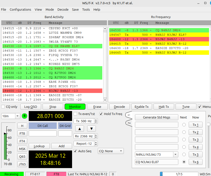

The good news is that the radio no longer stays in transmit when I plug in the USB or start WSJT-X. I tried to make some contacts. PSK Reporter shows signal reports for my 5W signal including some in Europe.

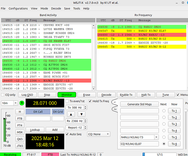

But then the problem starts. I tried restarting everything and the same pastern was seen. After about 2 transmission cycles no signals are seen on the water fall. I got responses on 2 QSO attempts, then everything just quit. I captured the last try.
I’m really dumbfounded as to what could cause the waterfall to ‘dry up’. I’ve had multiple QSOs with this radio and Digirig cables from Windows. The other difference is that Linux Mint is running on my only AMD based laptop, a Thinkpad model A475. The A475 runs Windows 10, but as I discovered AMD documents that there is not and never will be a Windows 11 graphics driver for the embedded graphics hardware. The Linux kernel has built-in support so it was an easy choice to switch to my favorite Linux desktop.

Starting up WSJT-X I found the audio input put showed as Not Found. I selected it again and started receiving signals. After transmitting, I lost receive very quickly. WSJT-X setup did not show an error for the device, but I found I could start receiving again by selecting the input device. Transmit continues to work and never drops out.
After input signals dropped out, there was no obvious issue found with dmesg and lsusb:
