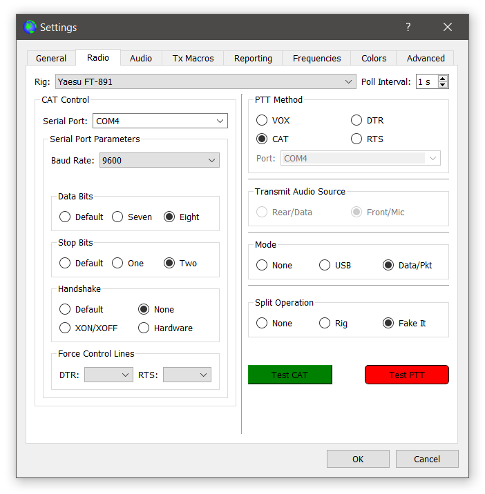

JS8Call has similar configuration form as WSJT-X. Here’s the screenshot from the setup manual for DR-891. Your setup will likely have different COM port number:
Make sure you get successful CAT test and PTT test before attempting transmission.
thank you. Unfortunately, most times the test buttons are just white, sometimes the test cat is red. I get a rig failure, hamlib error: IO error while opening connection to rig.
Are the settings in the screenshot above the same (except maybe COM port number) as in your software? Also, check that the transceiver settings match those in the setup manual.
it is, yes.
