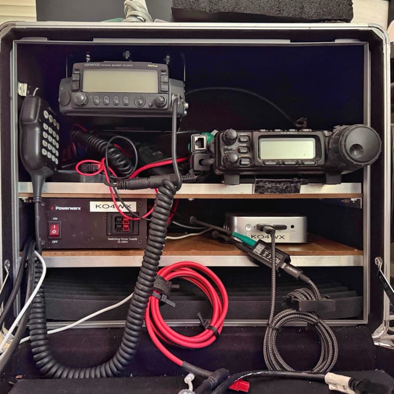

HOWEVER, it’s quite possible I have RF banging around the cables and the computer. I’m using an ACEMAGIC Mini-PC that is less than 2 inches from the rig. Attaching the configuration to this reply. I need to get a shorter USB-C cable. First thing I will do is slap some ferrite on the cables close to the PC. I MAY also have to build a Faraday cage for it.
Appreciate the quick response and will get back as soon as I can.

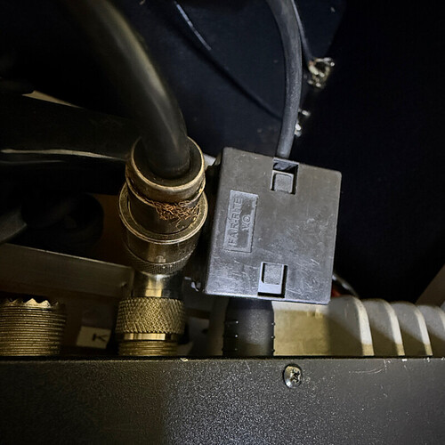

We have a winner. It is truly unfortunate that Yeasu located located the data port RIGHT next to the HF SO-239; as if they were daring the owner to not get RFI. So even though my differential tuner gave the rig 50 ohms resistive, the small ferrite(s) on the DigiRig data cable just couldn’t cut it.

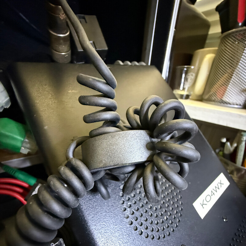

I took the belt and suspenders approach. Had an old Tandy snap on choke that I put as close to the port as physically possible and then wrapped as many turns of the coiled DigiRig cable through a -1” ferrite core of unknown type material. The run is so short, I may make up a shielded cable in its stead.
