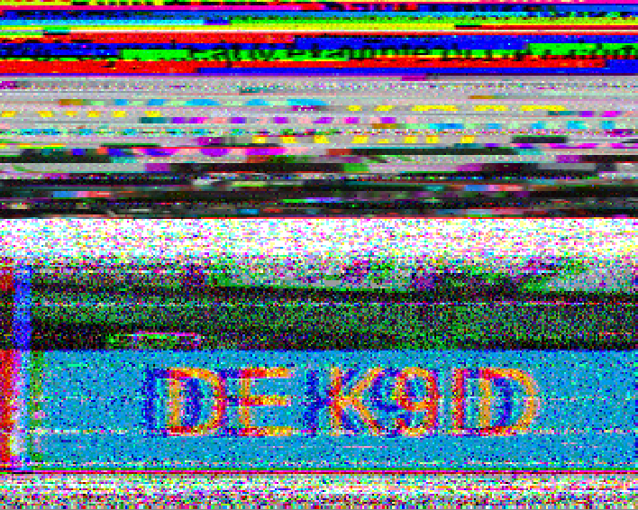

this is a screen of DroidSSTV where i have a soundcard plugged into my Samsung S7 active.
a little less than halfway through, i unplug/remove the usb soundcard/digirig and DroidSSTV continues to decode/rx using the built in microphone.
this is likely what’s happening to FT8CN as it does the same thing to me.
the waterfall looks ‘normal’ but nothing is ever decoded.
the signal ‘colors’ on the waterfall brighten/dim according to volume levels but again, nothing is ever decoded.
allowing FT8CN to run WITHOUT a usb soundcard attached to the Samsung DOES result in decodes.
so obviously, something with that generation of Samsung phones, hates usb soundcards.
the audio is being shifted back and forth/up and down which results in no decodes for FT8CN or DroidPSK or DroidRTTY or, as above, DroidSSTV
