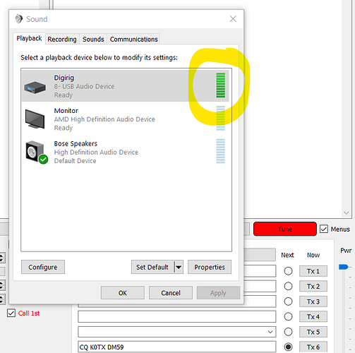

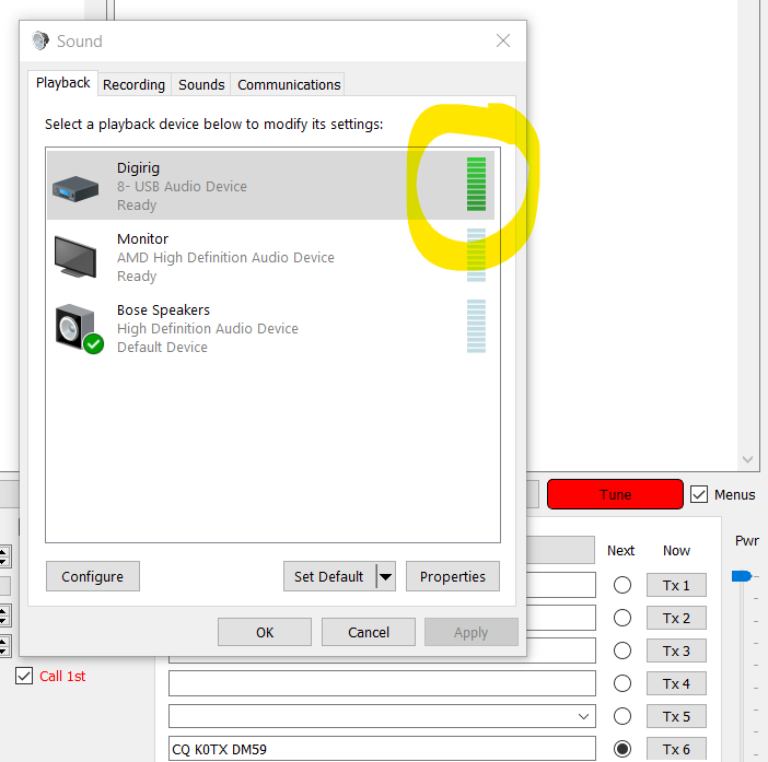

Good, that’s a datapoint. Do you see the green level bars next to Digirig’s playback device in the sound settings of the control panel?

While troubleshooting audio output from the Digirig so we need to generate some signal. You can use “Tune” feature in WSJT-X. If that wasn’t part of your earlier test with the headphones then that needs to be redone.
With audio going out we should be seeing something like this:

But running through the above posts I’ve been able to confirm that there’s audio out from the device, green bars about half way up. When checking the output on the DR891 there’s still no audio output. What would be the next recommendation?
