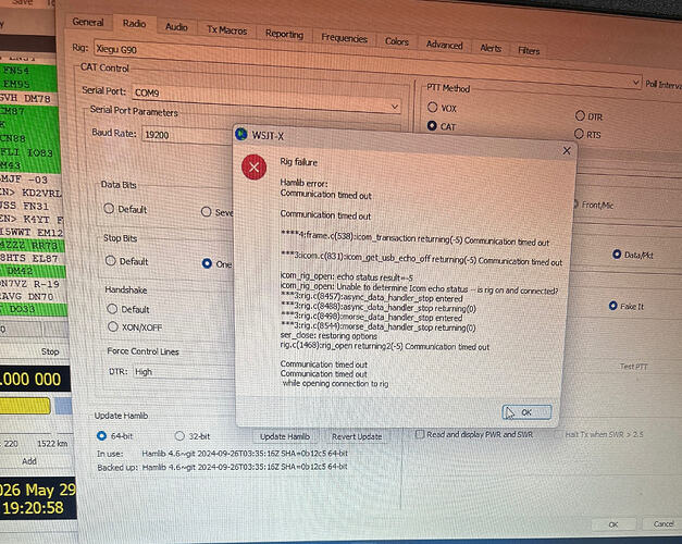

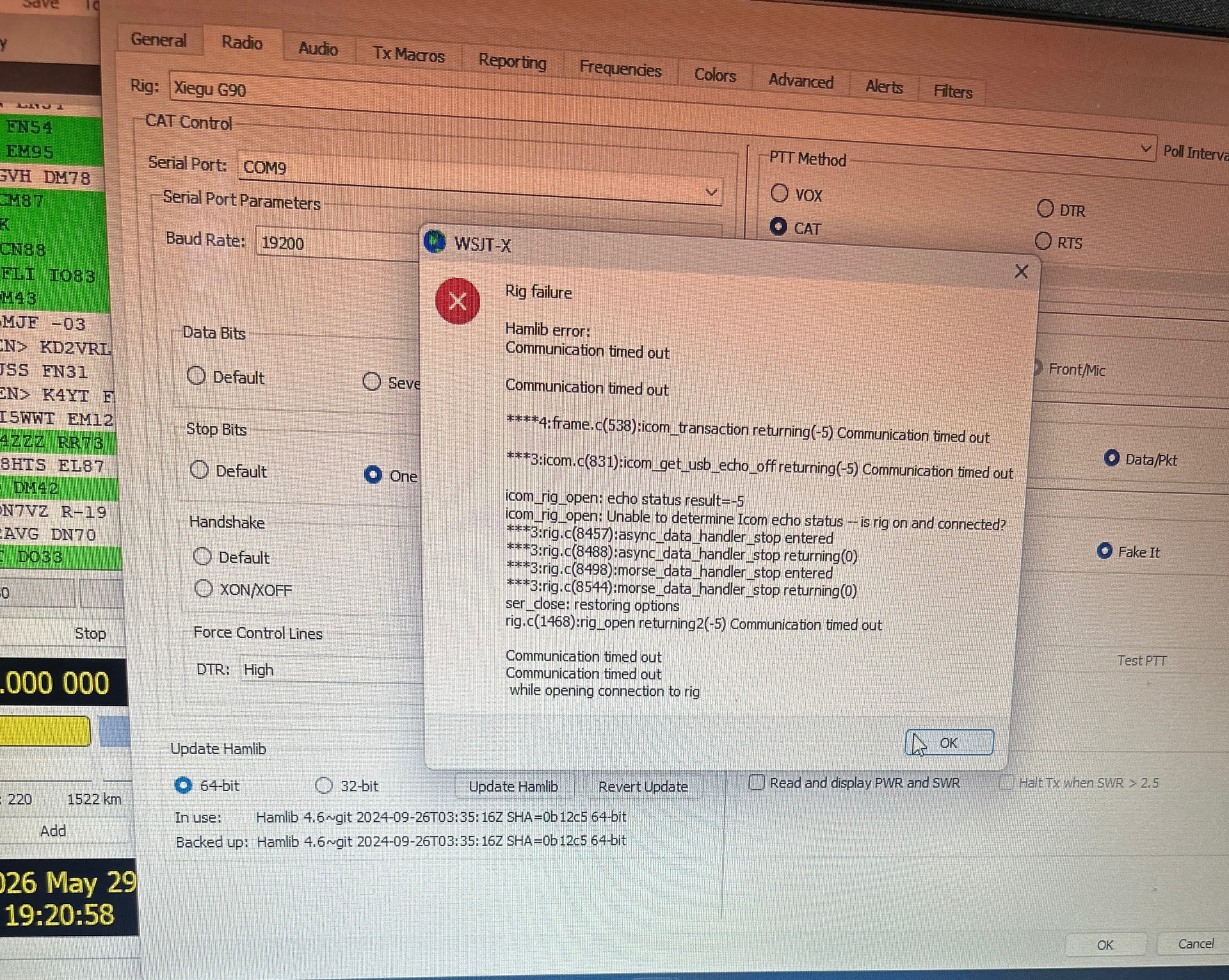

Here is the issue I get when attempting “Test CAT” in WSJTX without the use of middleware:
I have tried various different icom radios (in place of selecting the G90) both in WSJTX and OmniRig using this blue USB.
