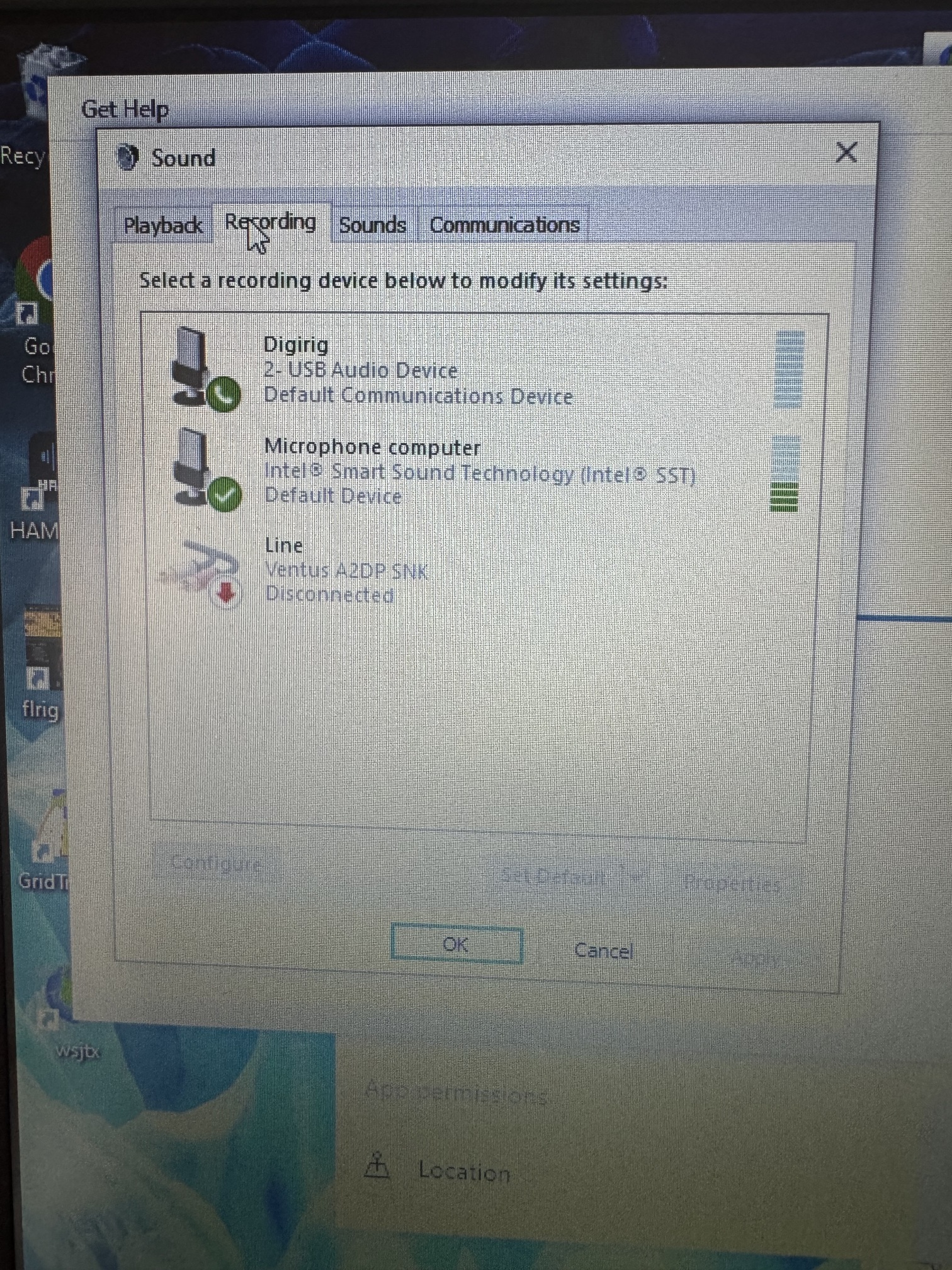

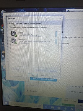

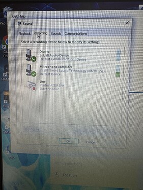

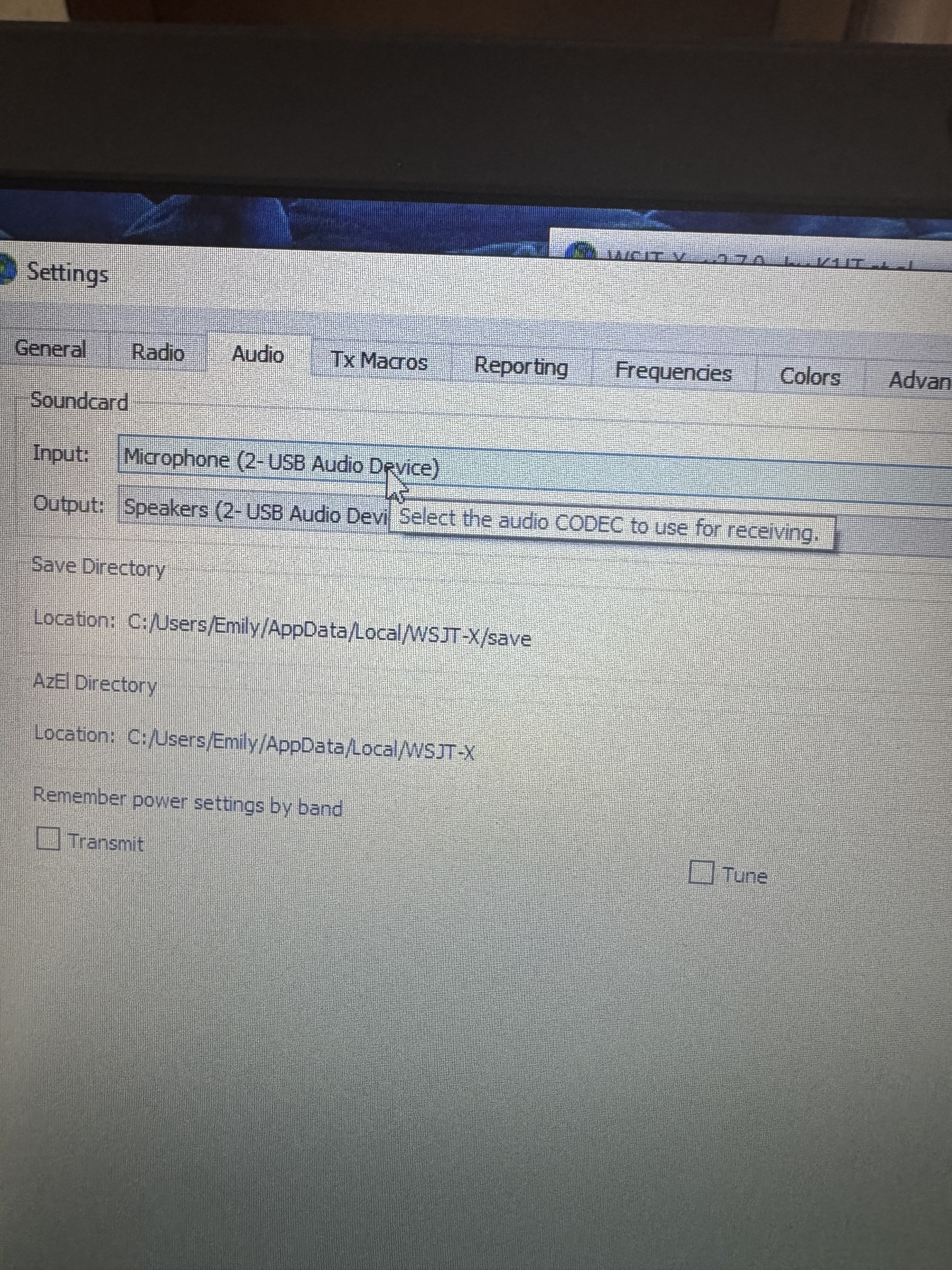

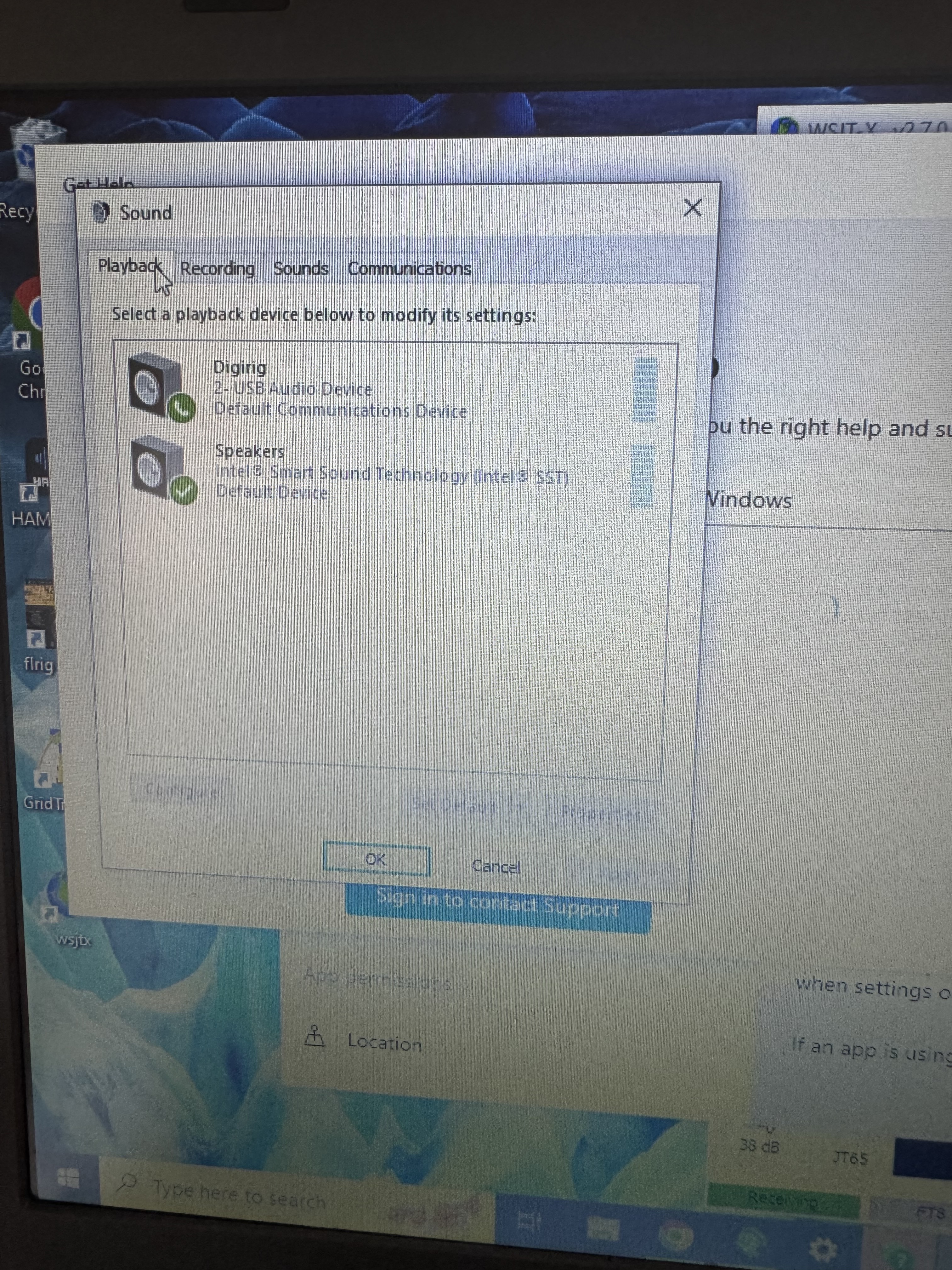

Hello,
I have been searching the forums for an answer to how to fix this issue but my computer doesn’t seem to be hearing anything from the digirig microphone output. I’ve tried on two different laptops and gotten to be able to test CAT and PTT which work but nothing shows up on receive. I have the radio set to U-D followed volume out settings on other forums. I was not able to see the microphone show it had any input in the sounds menu in windows 11.
