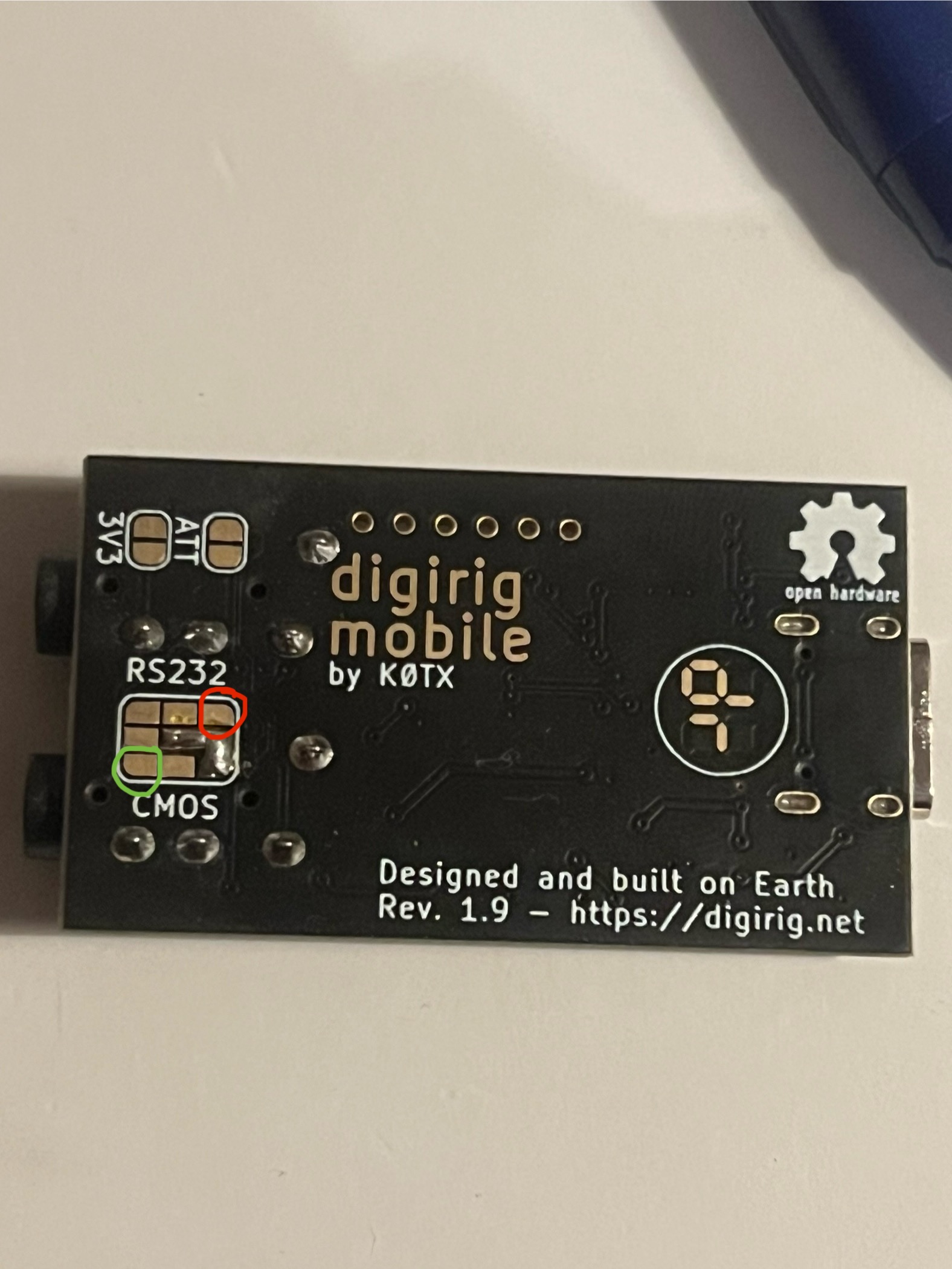

I’m having some trouble with my digirig mobile connected to an ic718 .. once the USB is connected to my computer my radio begins to transmit with no applications open…
I also cannot see any audio devices, this is on both windows and Mac, using multiple usb cables.
I have tried installing the silicon labs driver however nothing has changed.
When checking resistance I have found some power going between solder and the red circle, could this be the problem?
Any help would be much appreciated.
Edit * checking the pin for PTT shows zero volts when connected to computer with no applications open, the digirig also becomes very hot. I cannot see any solder on RS232
Is this a new unit or the trouble started after some time in use?
I’ve had the unit for a while now, I never used to have any issues with it but when I plugged it in this time and now it’s not working.
Since the same configuration worked previously (for couple years I recon from the revision), we can conclude that there is no issue with the connections solder pads.
There is likely a damage/failure in the UART chip which also supplies power to the USB hub. This would explain no USB devices detected and unit getting hot. I can repair it, but mailing back in forth between US and AU will make it a questionable value.
