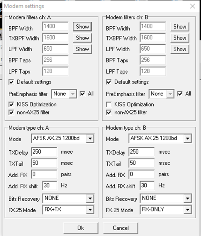

Jerome, I have this working on WIN11 with the FT-8900r. I’m close by if you need a tech assist!

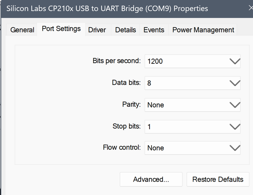

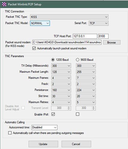

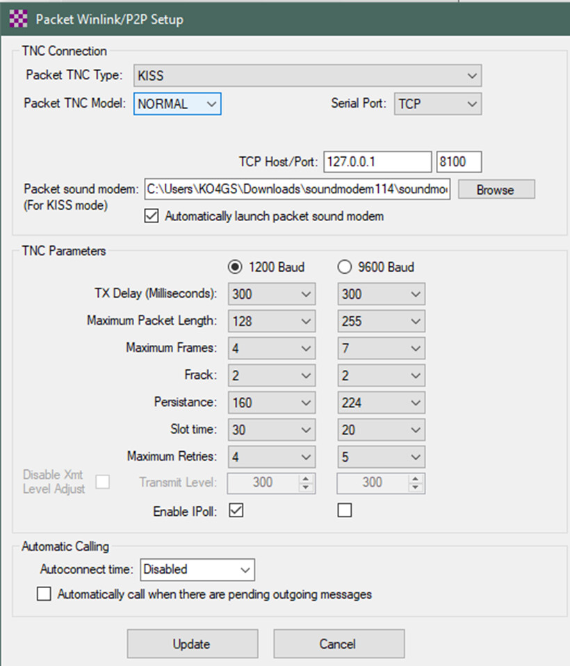

Packet WINLINK Settings. Obviously comport settings will vary - all should be set to 1200 Baud. Check the Com port properties in Device Manager and:
The Cable is connected to the Data Port on the 8900 and to the AUDIO port on the Digirig.

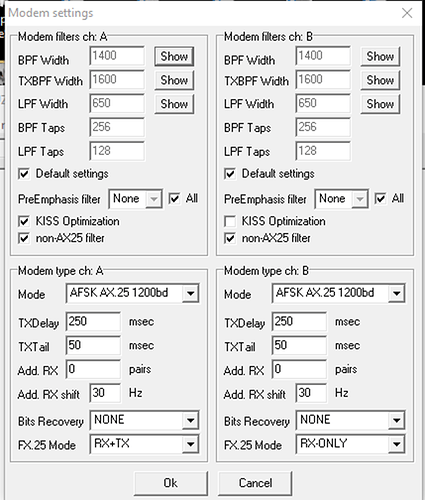

SoundModem

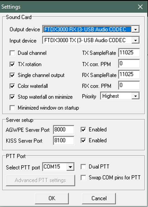

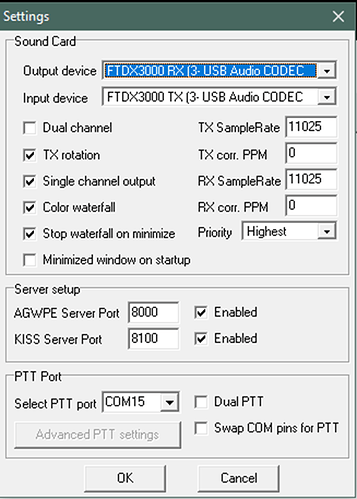

Devices:
Modems:
Howard, WZ4K
BTW, Disregard the Soundcard in and out devices on the screenshots which list FTDX3000. all other settings are good.
You WILL need to select the correct USB Audio in/out for your set-up. Should be something like:
Output: Speakers (USB PnP Sound Device)
Input: Microphone (USB PnP sound Device)
