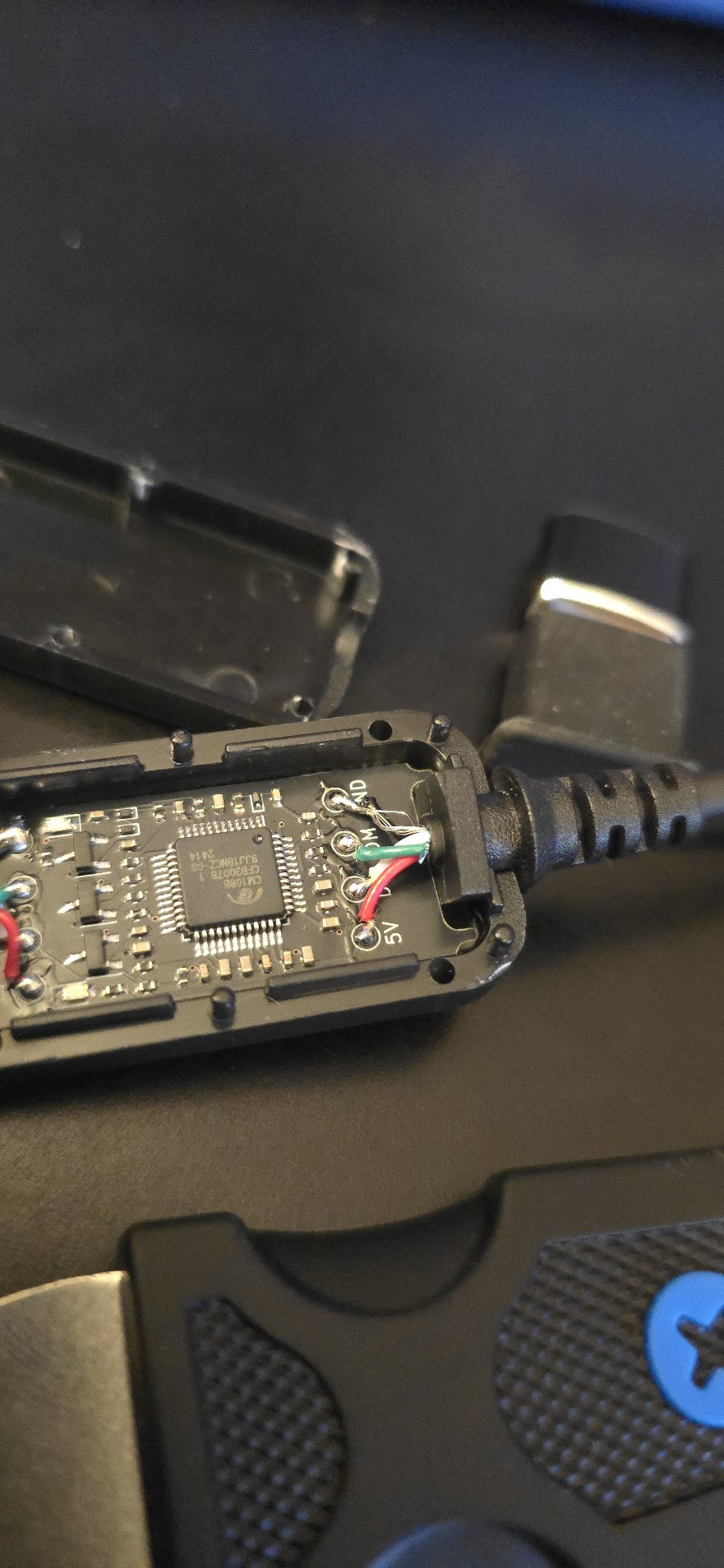

If none of the computers detect it, it is unlikely a software issue.
You can inspect the wiring on the USB side of the interface by using a sharp blade (xacto knife or box cutter) to gradually widen the gap around the perimeter of the enclosure until it opens.
Ah ha! The green wire is not connected to the board.
In fact, it was over near the white wire’s termination before I took this pic:
That checks out. Is this something you can handle locally?
If not, please reach out via the support form on the website with a service request.
I can re-attach green to DM.

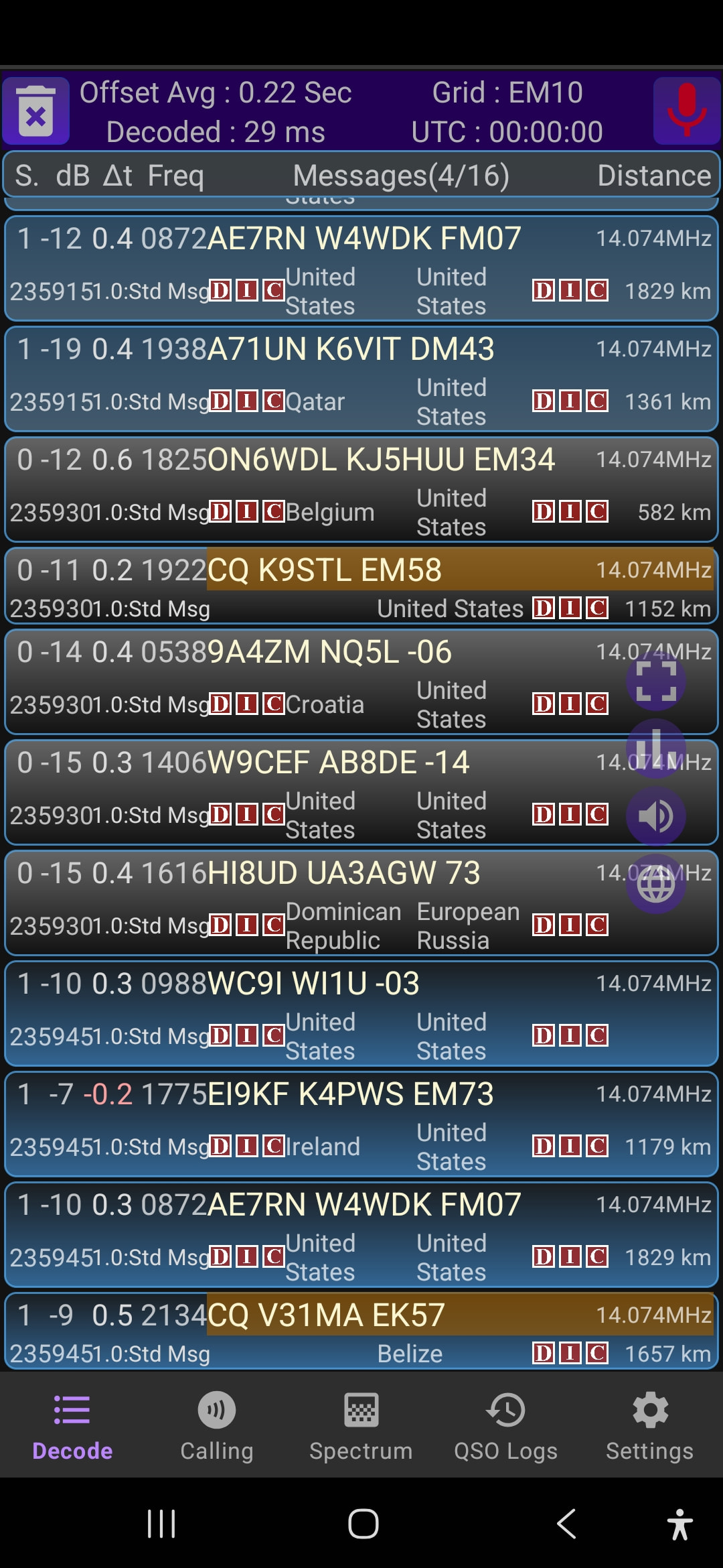

Alright.. so far, so good…
