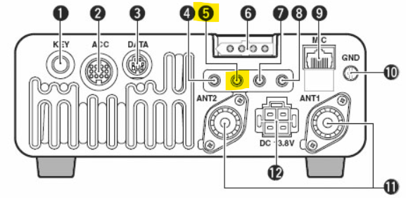

I recently acquired an IC-7000 and a digirig to go with it. I’ve been trying to get it to work on my windows computer via FLRig for use with WJST-X and WinLink to no avail. I have everything setup physically, but FLRig provides an error prompt stating the radio failed to initialize, but it will trigger the PTT to TX and leave it there. The only way to get it to stop TX is by unplugging the DigiRig from the computer.

Check that the angled jack is in the correct socket, it’s easy to miss

So, I believe it ended up being an issue with the angled jack. It ended up buffing out, for a bit. I am now experiencing another issue, but I’ll make an additional forum post about it.
