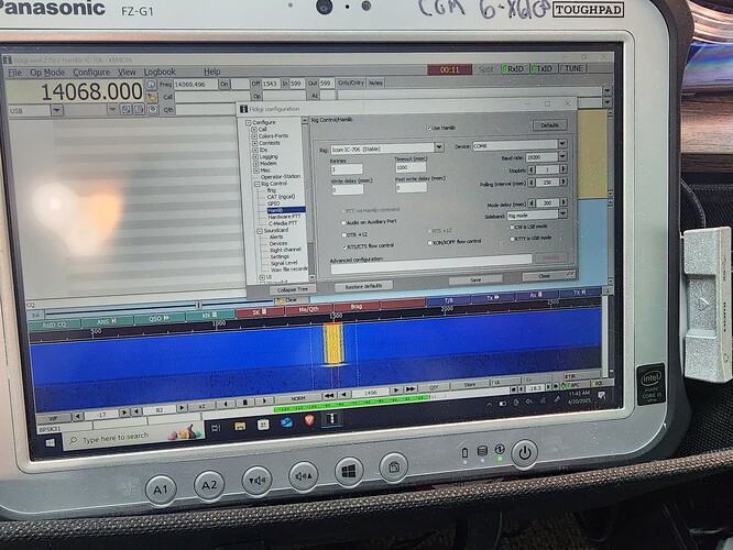

I have a new too me ic-706, the OG, not the mark2. I have the corect cables and digirig mobile. Works fantastic with JS8CALL and WSJTX. I have full cat control with both programs and see myself on pskreporter.
My jam are the modes in FLDIGI. But i cant get it to work with FLRIG to work, no mater what setting i select the ptt gets triggered and doesn’t stop untill i iether shut of the tranciever or program.

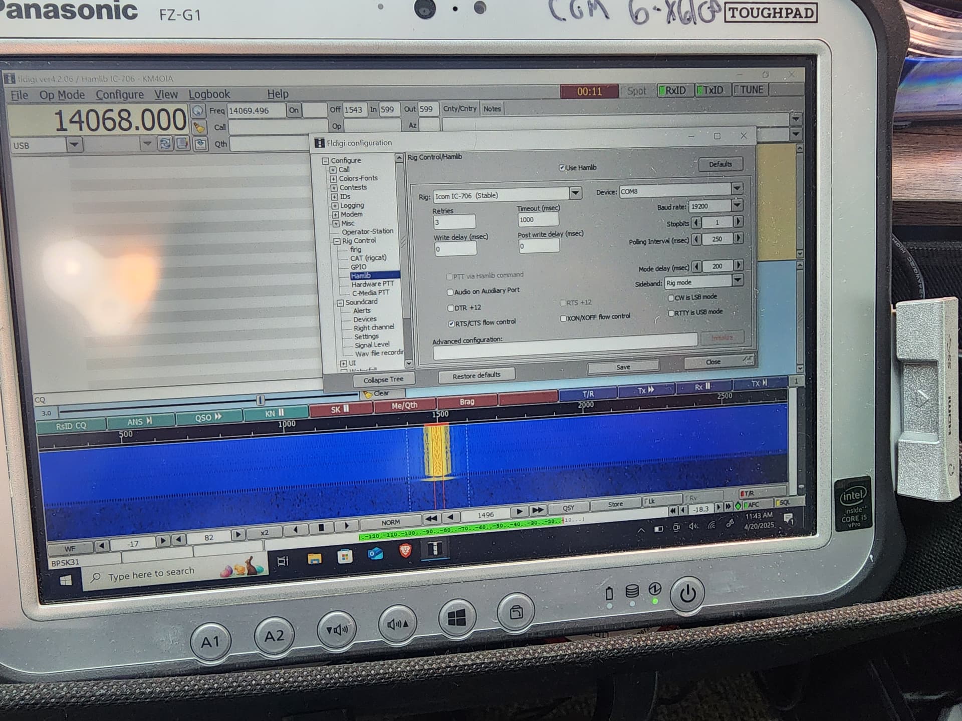

In fldigi under hamlib i get it to have cat control and decoding others in psk31 and other modes, just cant get it to key the ptt,

Seams like this is the most stable. Still wont key on the ptt. If i use the hardware ptt sett8ngs it keys up and gets stuck. I havent had any problems with WSJTX
