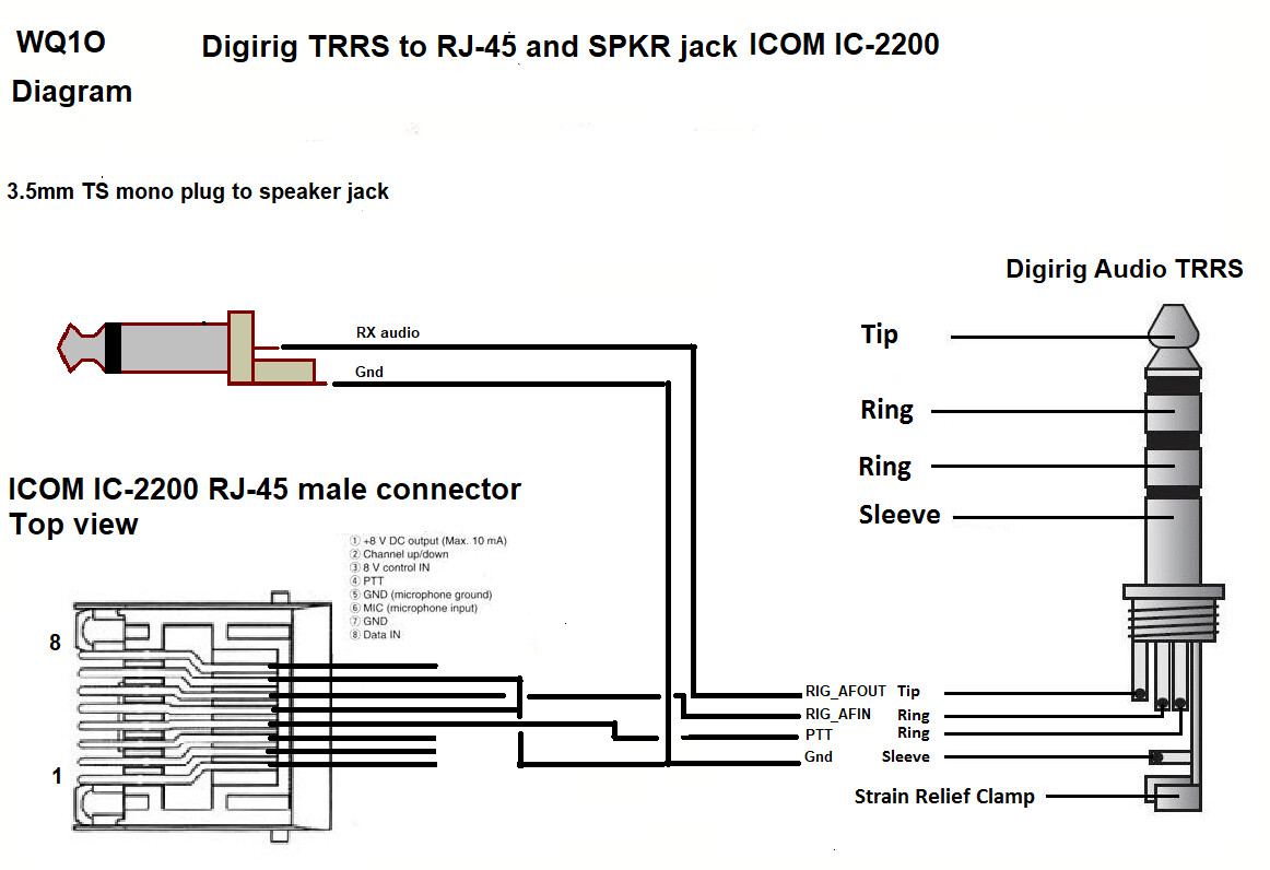

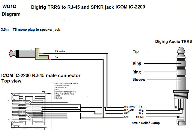

I used one for winlink and NBEMS VHF with an IC-2200 (same pin out) using a Digirig when Denis first started making them. KB0WLF is right. Get it at logic levels as you won’t need CAT. If you are making your own cables, you can use my diagram. If you are buying cables from Denis, you are good to go. I made mine originally as cables weren’t available yet for many of the ICOM mobiles with RJ-45. Denis has some nice cables. I recommend them for most folks… unless you are an avid DIY person who really prefers building.
