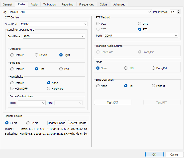

do you have PTT set to RTS of the digirig mobile comport?

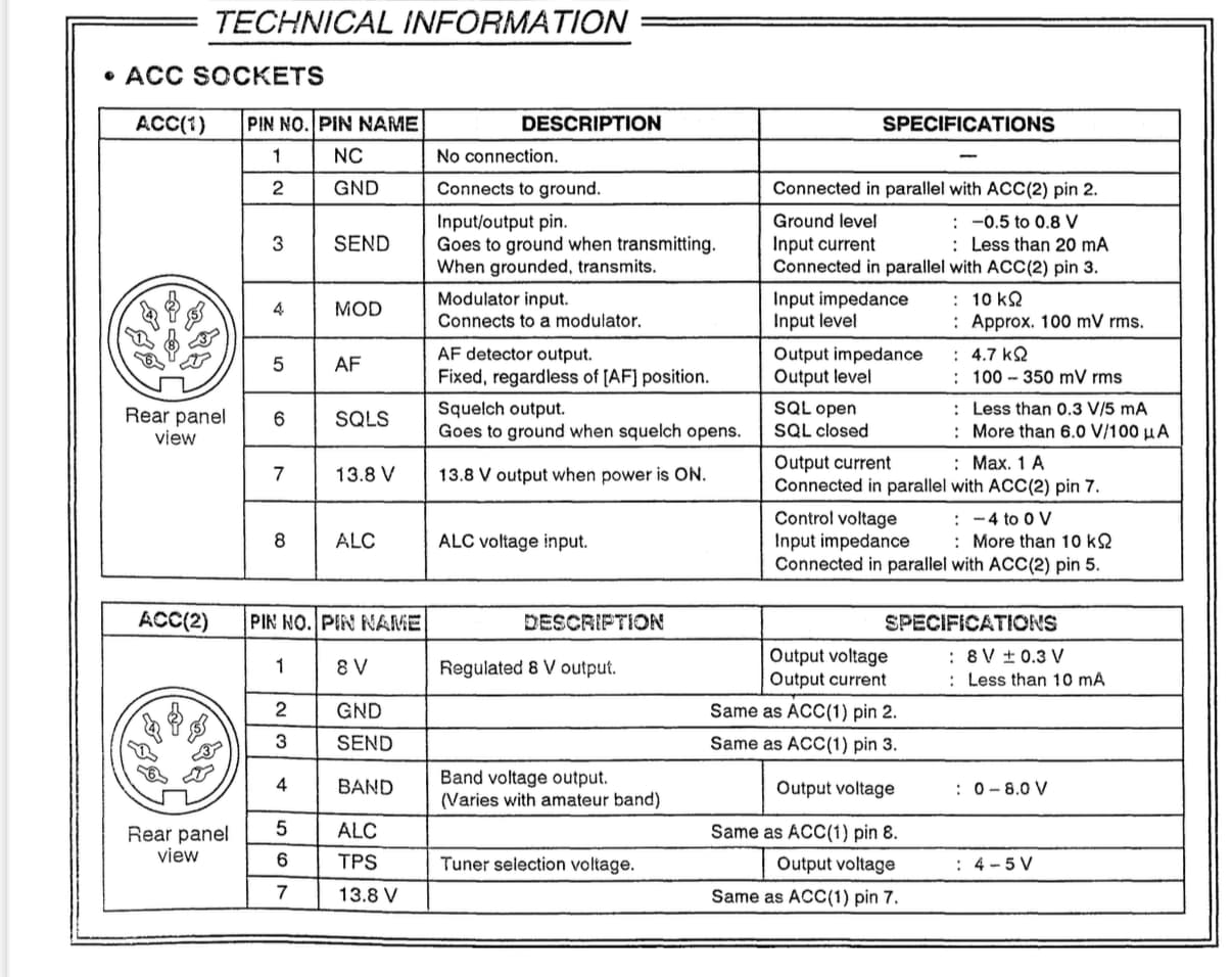

can you try pulling the audio/ptt cable out of the digirig and jumping the sleeve and ring 2 of the digirig end of the cable ?
this should put the radio in TX.
(just to check operation of the cable/radio connection)

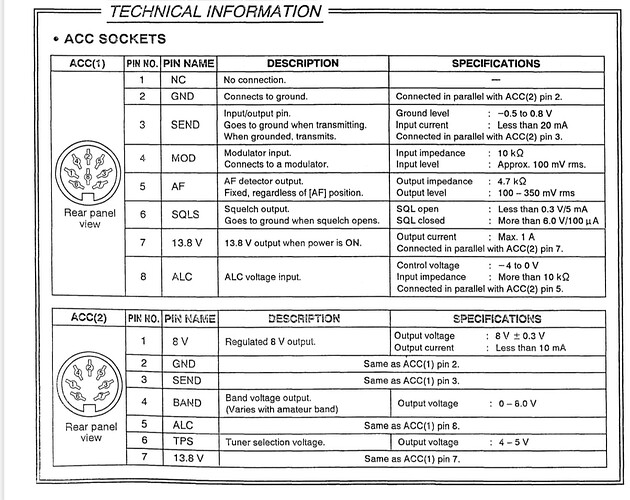

the radio will ptt from the acc port pins
in wsjt-x, on the ‘radio’ page of the settings, there are ‘test cat’ and ‘test ptt’ buttons.
do they do anything?
you can just use the test ptt button and not mess with the cat button to start with
—> if you wouldn’t mind, on that page, select RIG: NONE
just to focus down onto the PTT issue.
of course leave the PTT sections as you have them assuming com7 is still the correct comport # (a simple thing like using a different usb port will change the # on you)

When I click the PTT the button turns red but the radio doesn’t go into transmit mode.
i’m stumped.
is the cp210 vcom driver installed for the digirig serial port?
(with the selection of com7 i’m assuming it is :slight_smile: )
that’s the only thing left i can think of.
your settings look fine to me.

for split. maybe try that or none for split.
(perhaps hamlib sends a cmd via ci-v for ‘rig’ that the ic-718 doesn’t like?)

If it’s still not driving PTT—you may have tried this already—hook a meter between the sleeve and ring 2 and make sure pin 2 goes to ground on transmit.

on the acc1 din8, there is audio in/out and ptt
