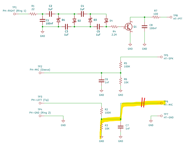

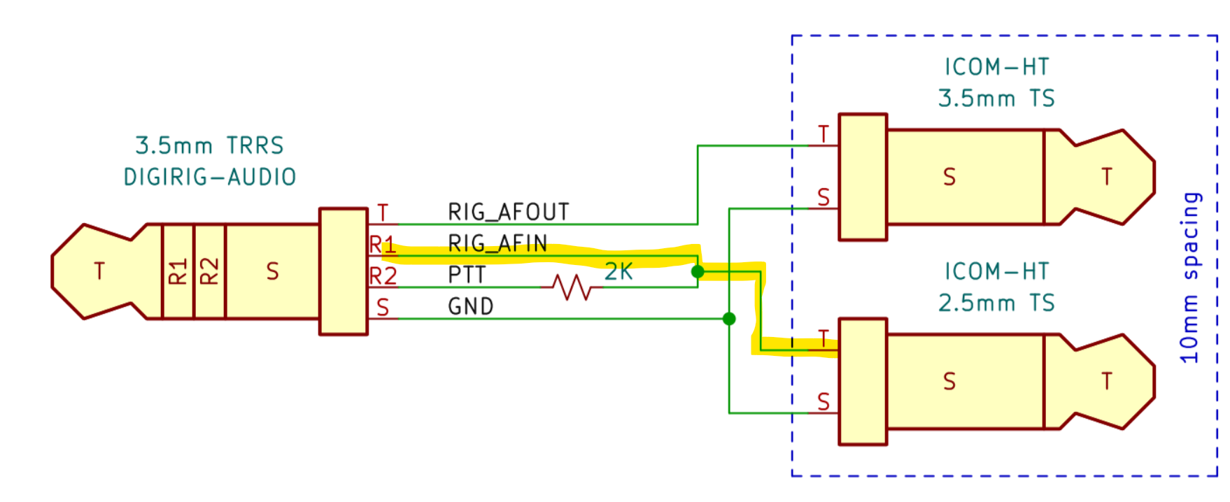

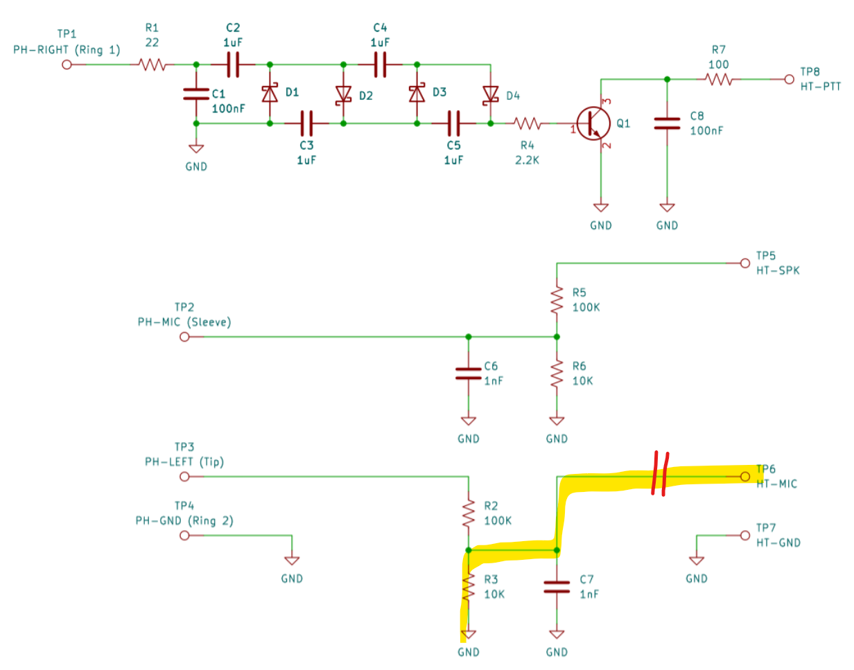

These are likely unrelated issues since the interface models in posts are different (VOX PTT vs Digirig Mobile). Looking at the potential cause of the issue with VOX PTT cable, it can be related to the specifics of the ICOM HTs sharing the same line for audio in and PTT and having particularly touchy PTT line:
The PTT may be activated by the lower leg of the mic level attenuator in the VOX cable even though the resistance is quite high:
In the next batch of VOX cables I’ll look into adding a decoupling capacitor on the transceiver side of the mic line to work around this issue. For now if you don’t have use for the cable with other transceiver models, feel free to reach out via the contact form to arrange a return/refund.
