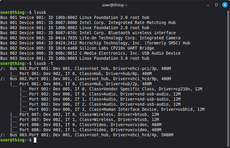

My (first?) problem is that I cannot identify the usb ports in use by digirig: I cannot see an unambiguous match between what linux reports, and the options in wsjt-x settings for the ports.
From the above I can see that the laptop finds digirig, but how does this relate to the port options in wsjt-x? Don’t let the above fool you into thinking I am good with terminal. I just type what I am told to!

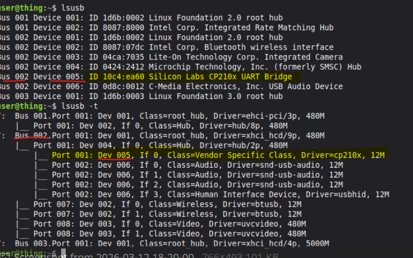

Here’s Digirig’s serial port:
In the software configuration you’ll be referencing entities from under /dev/
Key Identification Commands
  • lsusb: Lists connected USB devices; look for “Silicon Labs CP210x UART Bridge”.

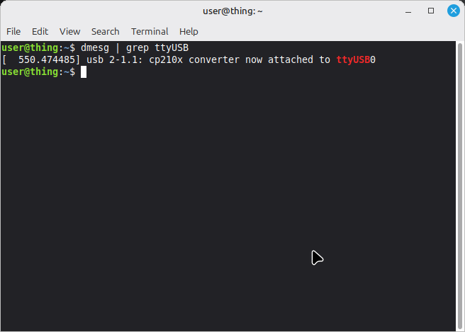

  • dmesg | grep ttyUSB: Shows kernel logs to confirm which ttyUSBx port the device attached to.
  • ls -l /dev/ttyUSB*: Lists all active USB serial ports.
So hopefully I’m correct to enter /dev/ttyUSB0 as the serial port under CAT control in wsjt-x?

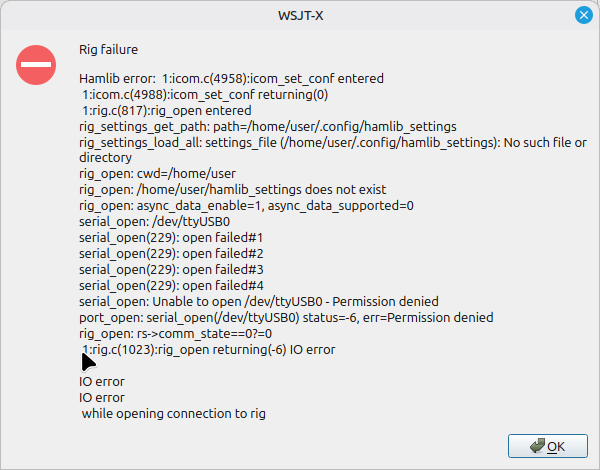

Had a go and not sure if I’m discovering another problem or still seeing a usb problem.
Maybe check and perhaps change the file permissions on /dev/ttyUSB0 to allow the user running wsjt–x to read/write/execute.
Also, what’s going on with .config/hamlib_settings? Does it exist, with proper permissions?
A bit of a search revealed that linux can be funny about ports due to legacy unix? stuff, and so I tried *sudo adduser user dialout (*my username being “user” on this laptop)
